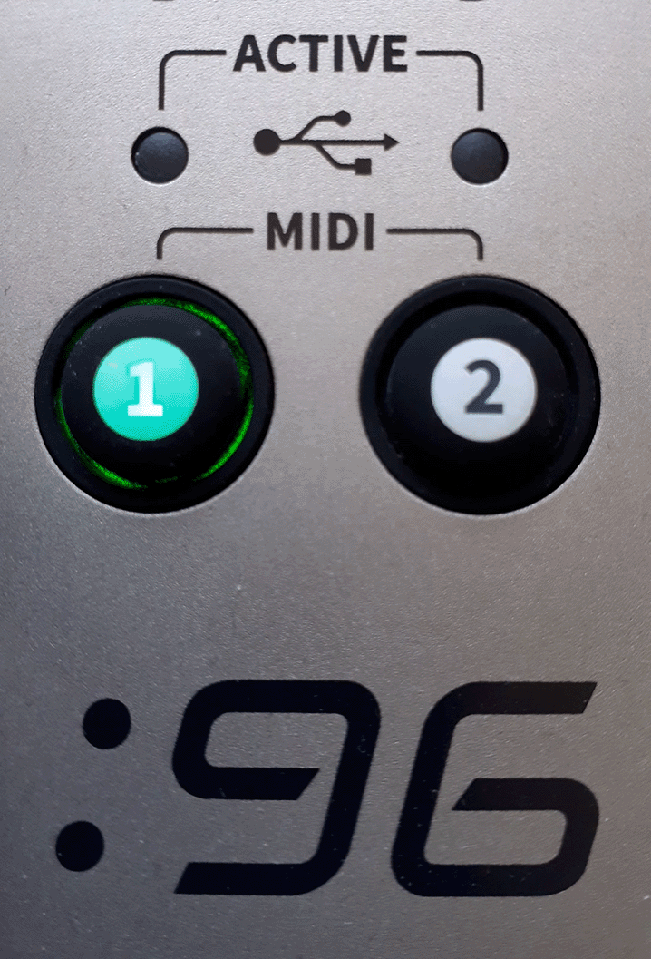

To switch modes, simply press and hold all three HP,BP,LP filter type buttons on both filter 1 & filter 2.
The Two MIDI active buttons will start to flash as shown below.
The 96 is now running in the alternate cue mode.
