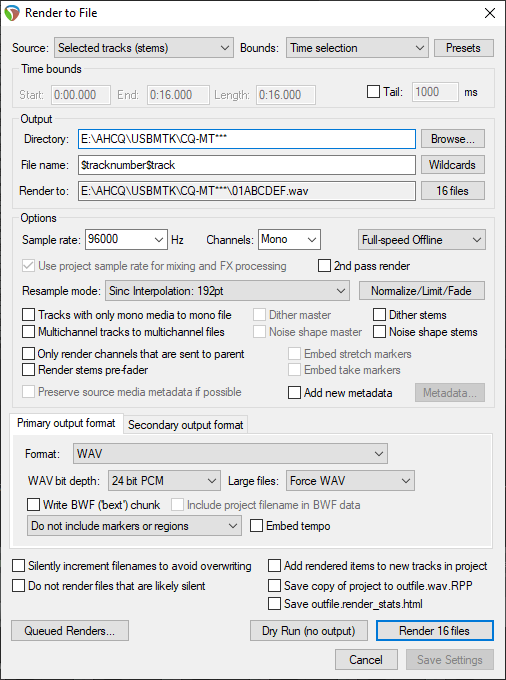

Render new audio files:
- Go to 'File > Render'…
- Use the following settings (anything not described in the text below is up to you and relates mostly to quality/speed of render):
- Source: Selected tracks (stems)
- Bounds: Time selection
- Directory: '[SD]:\AHCQ\USBMTK\CQ-MT***' where the multitrack folder name ('CQ-MT***') can be any multitrack folder name/number that has not previously been used.
Note that rendering directly to the SD drive may be slow, in which case, simply render to a local drive (such as your main hard drive) first, then copy files across to this folder on the SD card when rendering has completed. - File name: '$tracknumber$track' - this is the track number wildcard which will tell the CQ which channel to playback the audio to, followed by the track name wildcard. The total length of the file name must not exceed 8 characters in total (2 characters for the track number and up to 6 characters for the track name).
- Sample rate: either 48000 or 96000
- Channels: Mono
- Ensure 'Tracks with only mono media...', 'Multichannel tracks...', 'Metadata' and other boxes are not ticked
- Format: WAV
- WAV bit depth: 24 bit PCM
- Large files: Force WAV
- Ensure 'Write BWF ('bext') chunk' is not ticked
- Select 'Do not include markers or regions' in the drop down below the BWF option
- Ensure 'Embed tempo' and all 4 other tick boxes below are not ticked
- Click 'Render * files' where * should match the number of files you are expecting to render.
