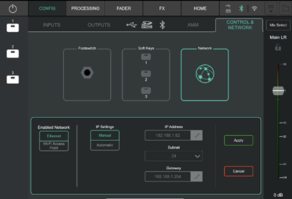

On your CQ Unit:
- Go to CONFIG / CONTROL & NETWORK.
Touch the NETWORK box and select ‘Ethernet’ at the Enable Network option. - Select Manual to enter the necessary Network settings that will enable communication within your Network environment.
- IP Address: Enter an IP address that follows under the same IP range of your Access Point; Choosing which bits of the IP Address are to be changed while assigning an Address to a device will be dependent of the selected Subnet Mask.
- Subnet: The number selected in the Subnet drop-down menu will indicate the octet or section of bits that are set as Network ID and which bits can be used for assigning individual Addresses.
By default, the Subnet is set to 24, which indicates that the first 3 octets or bytes are fixed, while the last byte is available to assign an address from 1 to 254 (Effectively equal to 255.255.255.0) - Gateway: This is to be defined by the Gateway of the Access Point.
Example: If your Access point has a Subnet Mask of 255.255.255.0 and an IP Address of 192.168.1.100, you may want to have an equal Subnet Mask (24 for 255.255.255.0) and an IP Address of 101, if no other device is already using this Address.
- Select Automatic for your Access Point to automatically deploy and assign an available IP address under the same IP Range and under the same Subnet Mask. This option is recommended for a quick and safe way of guaranteeing a good Network connection.
- If your Access Point is set as a DHCP Server, your CQ console will automatically receive the assign IP Address.

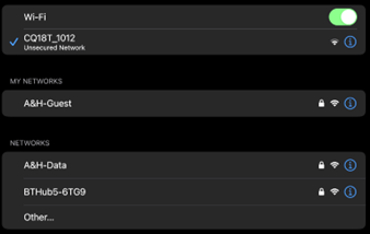

On your external device:
- Go to your WiFi Networks, locate your Access Point Network and connect to it.
- Once connected, Open the MixPad app and wait a few seconds for your CQ console to appear in the ‘Choose Unit’ menu.
- Select your CQ unit and connect.
