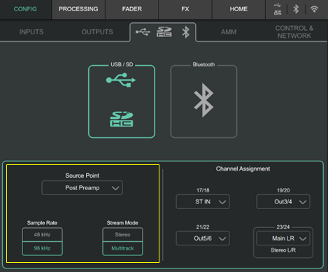

Sending audio from your CQ to a DAW
1.- On your CQ, go to CONFIG / DIGITAL AUDIO / USB/SD
- Select the Source Point from which the signal will be sent to the USB Interface.
- Select the Sample Rate at which your DAW session is being configured.
- Select Multitrack.

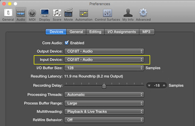

2.- Go to your DAW and open the Audio Preferences
- Locate the INPUT Source selection and select your Allen and Heath CQ

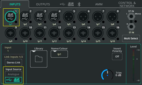

Sending audio from your DAW into the CQ
- Locate the OUTPUT Source selection and select your Allen and Heath CQ
3.- Select each track and locate its Output Source selection, then assign an Output channel for each track in the order that you wish to receive them on your CQ console layout.
4.- On the CQ, go to CONFIG / INPUTS and select the required channels according to your DAW output assignments; Use Multi Select to select multiple inputs at the same time.
5.- Switch Input Source to USB/SD
6.- Done! Signal will now be sent to the CQ from the DAW and can be routed and processed as required.
