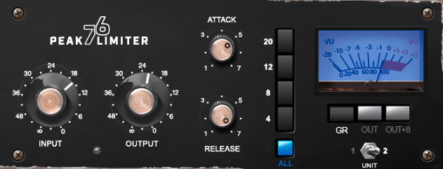

Peak Limiter 76 Compressor Limiter
Two versions of the renowned FET levelling amplifier. One vintage, one more modern, both with all-button mode.

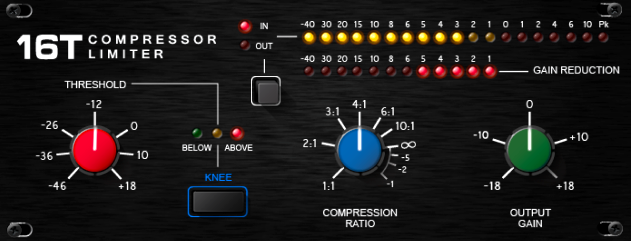

16T Compressor Limiter
Tight and punchy VCA-based RMS compressor, with natural sounding gain reduction.

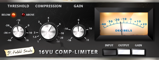

16VU Compressor Limiter
The classic VCA-based RMS compressor. Musically enhances low-mid frequencies when driven.

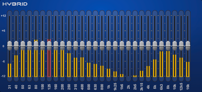

Hybrid GEQ
A combination of the Proportional-Q and Constant-Q units providing smooth boosts and clinical cuts.

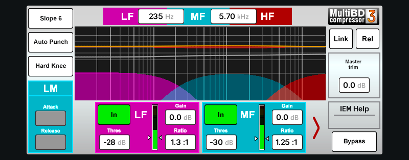

MultiBD3 Multiband Compressor
Fully featured 3 band compressor for dynamic control on input or mix channels.

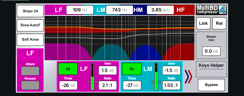

MultiBD4 Multiband Compressor
Fully featured 4 band compressor for dynamic control on input or mix channels.

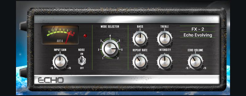

Echo Tape Delay
Faithful reproduction of the classic tape echo unit.
