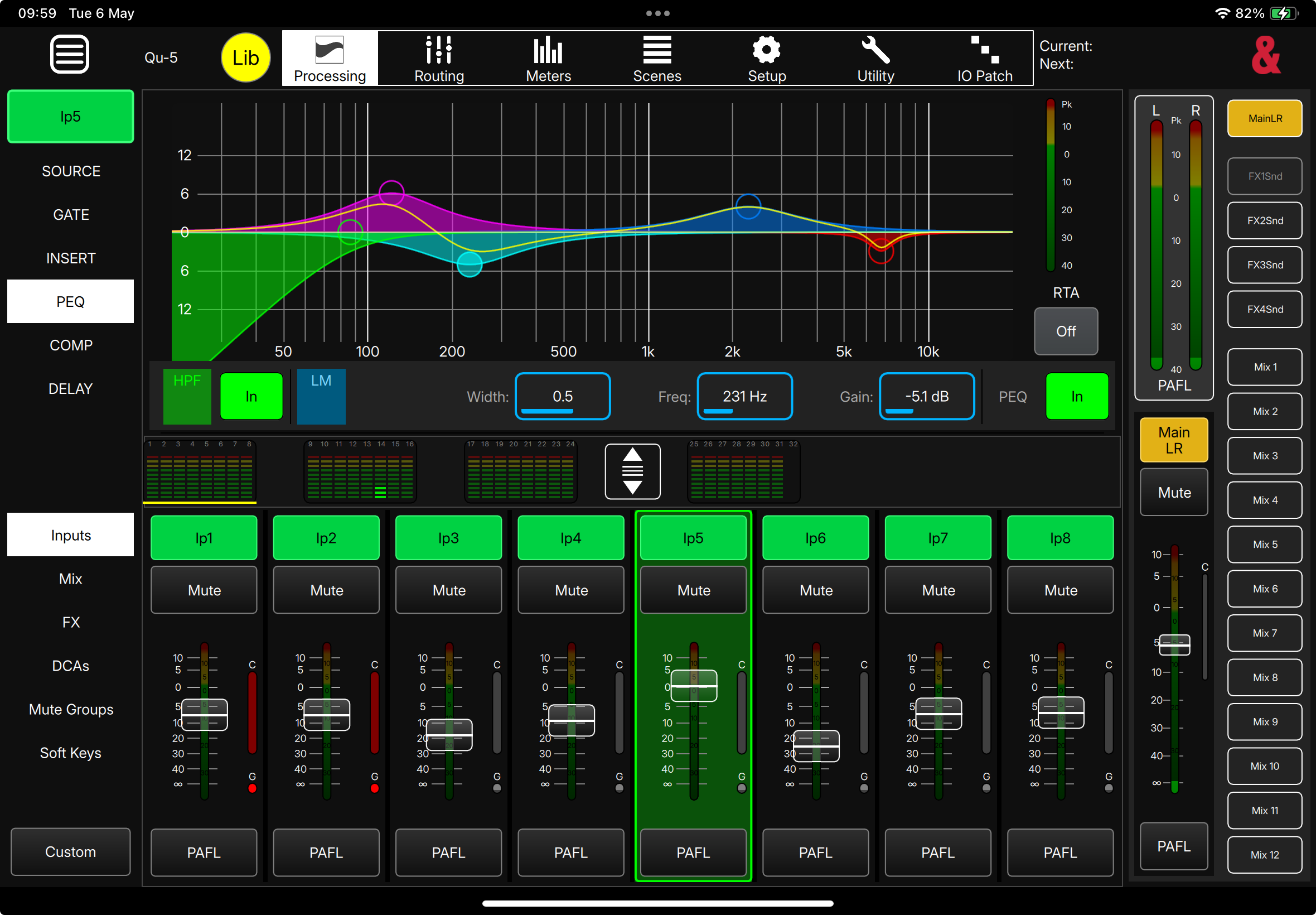

The Qu-MixPad app provides full remote control of the Qu over a network for the engineer.
Qu4You is an easy-to-use personal monitoring app, which also works over a network, and controls the send levels to just one of the outputs.
Up to 8 app instances can be connected to a Qu at once, with up to 2 of these being Qu-MixPad and any remainder being Qu4You.
Note that only control messaging is shared over the network connection between the Qu and any connected app, no audio is transmitted or received.

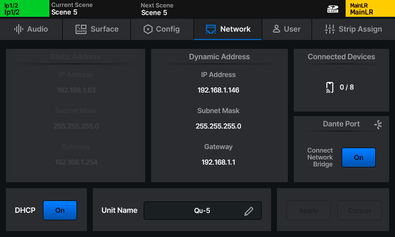

Connecting Apps
|| SETUP | Network
- Connect the Qu to the external router or network as a client, using a network cable connected to the network port. Follow instructions on any router or access point as if the Qu were a computer (e.g. connect to a LAN port).
- Navigate to SETUP > Network
Setup the network. It is recommended that DHCP is set to On, to allow automatic address assignment via DHCP where possible. Setting DHCP to Off should only be required where a DHCP host is not available, or for setups where an IT or networking team needs to allow access.
ⓘ When DHCP is turned On and no IP address is provided to the Qu, it will auto-assign itself an address. This is noted by a (*) appearing after the address in the network config and system information screens.
- Connect a device to the same router, access point or network. It is also possible to connect a device directly.
- Run Qu-MixPad or Qu4You and connect to the Qu from the Choose Unit list.
