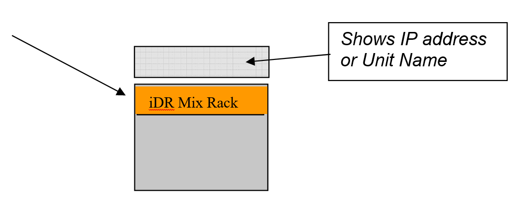

STEP 2 Select the MixRack:
- In the touch screen Utility page select Network.
- Touch the Network Connections button (not Network Setup).
- Touch the Change MixRack
- Touch the MixRack
- Press Apply
- Press Reset Touch Screen

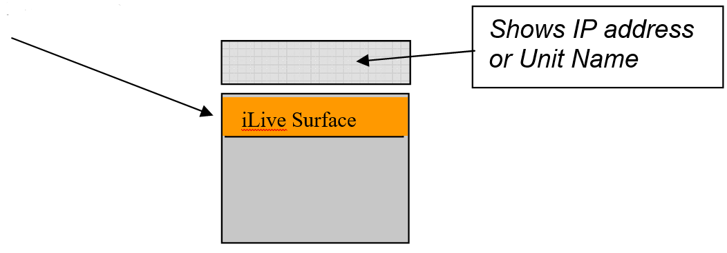

STEP 2 Select the Surface:
- Touch the Network Connections button (not network Setup).
- Touch the Change Surface
- Touch iLive Surface
- Press Apply
