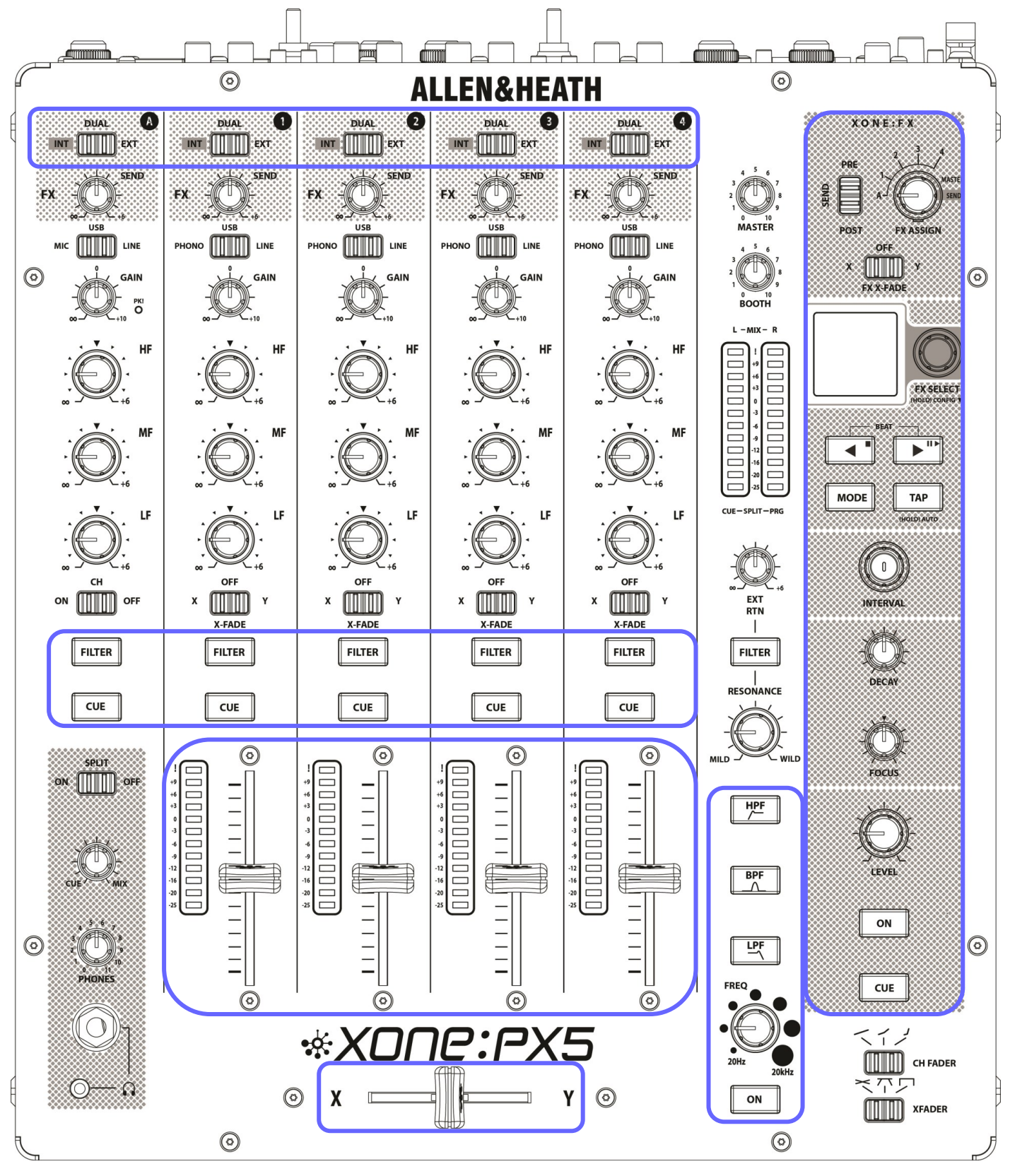

The Xone:PX5 has the ability to send and receive MIDI and features a total of 51 MIDI enabled controls;
39 buttons/switches, 5 Faders and 7 rotary controls, that can be assigned to enable control of various parameters in DJ performance software, or DAW (Digital Audio Workstation) applications.

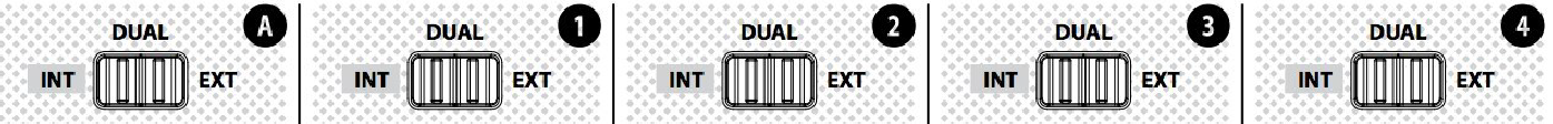

Channel FX MODE Select Switches
| XONE:PX5 CHANNEL | FX MODE | ||
| INT | DUAL | EXT | |
| A | C-2 | OFF | C#-2 |
| CH16 | < > | CH16 | |
| 1 | D-2 | OFF | D#-2 |
| 2 | E-2 | OFF | F-2 |
| 3 | F#-2 | OFF | G-2 |
| 4 | G#-2 | OFF | A-2 |

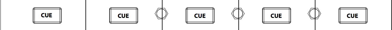

Channel CUE Select Switches
| XONE:PX5 CHANNEL | CUE |
| A | E-1 |
| CH16 | |
| 1 | F-1 |
| CH16 | |
| 2 | F#-1 |
| CH16 | |
| 3 | G-1 |
| CH16 | |
| 4 | G#-1 |
| CH16 | |
| XONE:FX | D1 |
| CH16 |

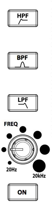

Xone:VCF
| FILTER | HPF | BPF | LPF | FREQ | ON |
| A-1 | A#-1 | B-1 | CC5 | C0 | |
| CH16 | CH16 | CH16 | CH16 | CH16 |

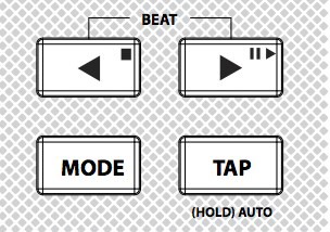

Xone:Sync
| XONE:SYNC | BEAT LEFT | BEAT RIGHT | BEND LEFT | BEND RIGHT | STOP | PLAY |
| F0 | F#0 | G0 | G#0 | A0 | A#0 | |
| CH16 | CH16 | CH16 | CH16 | CH16 | CH16 |

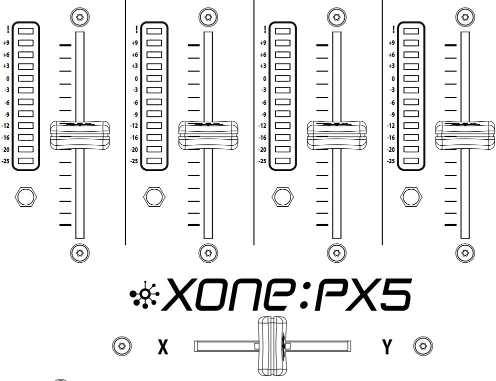

Faders
| XONE:PX5 CHANNEL | FADER |
| 1 | CC0 |
| CH16 | |
| 2 | CC1 |
| CH16 | |
| 3 | CC2 |
| CH16 | |
| 4 | CC3 |
| CH16 | |
| X-FADER | CC4 |
| CH16 |
