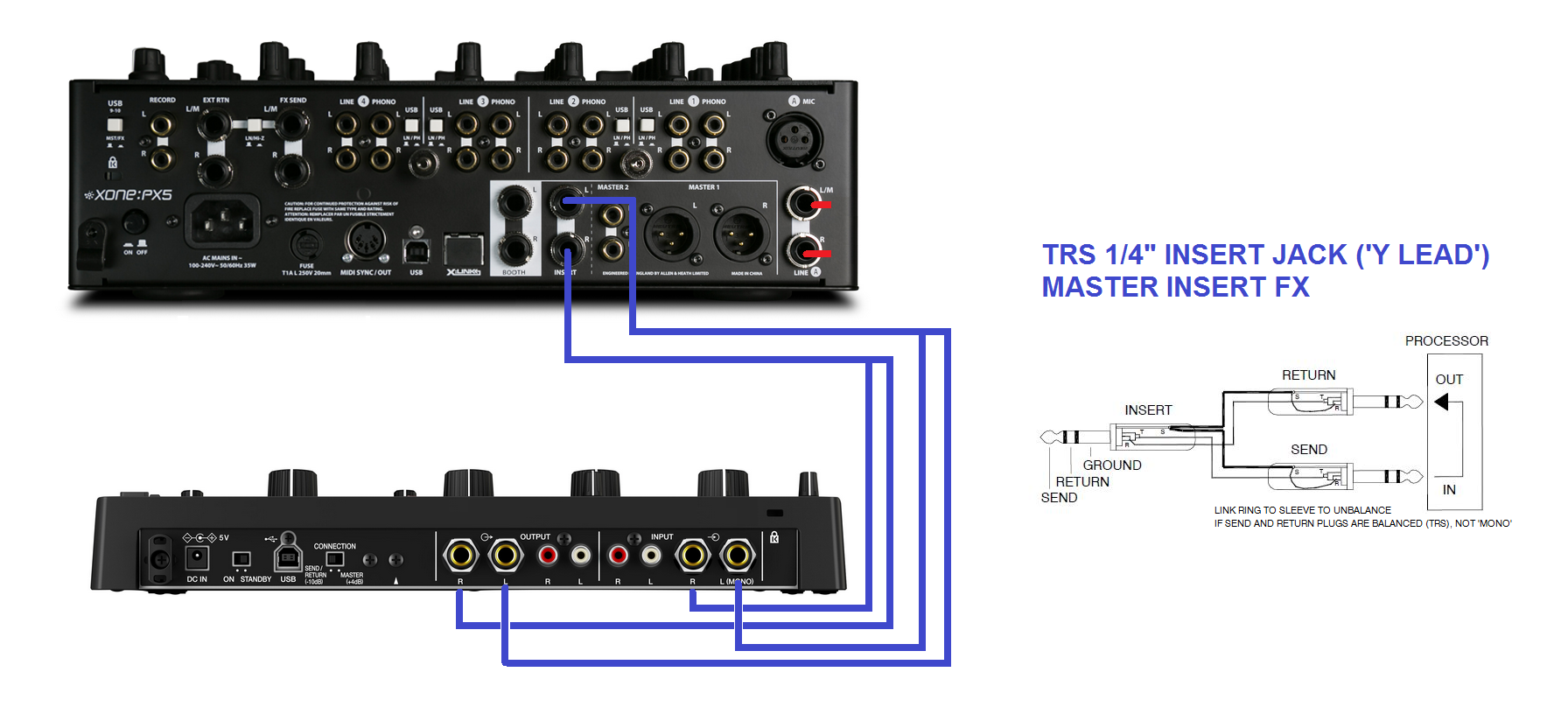

Xone:PX5 Master Insert system. Connecting an RMX FX unit
- Connect ¼” (6.35mm) INSERT patch cables, wired TIP=SEND / RING=RETURN / SLEEVE= (common) GROUND, from INSERT L and R on the mixer to INPUT L and R and OUTPUT L and R sockets of the RMX.
- Set the CONNECTION switch to MASTER on the RMX.
- Set the PX5 channel sources and ensure signal is present in the main mix.
- Adjust the INPUT and OUTPUT levels on the RMX and set for unity.
- Play with the RMX parameter controls to shape the sound.
