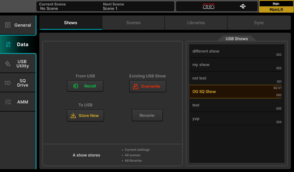

Entire SQ Show folders can therefore be copied from \AHSQ\SHOWS to \AHSQ\SQP-SHW for use with an SQ+
SQ Scene files can be copied from \AHSQ\SCENES to \AHSQ\SQP-SCN,
and SQ Library files from \AHSQ\LIBRARY to \AHSQ\SQP-LIB
ⓘ As all data is numbered starting at 0 for each SQ or SQ+ folder, be careful not to overwrite any SQ+ data that has already been stored on the drive!
Once copied, the data can be seen and recalled (and overwritten) by the SQ+ in the same way as all other data.
ⓘ Sharing the same root folder but having different data folders allows audio recorded on SQ to be played back on SQ+ and vice versa. The separate data folders prevents SQ from being able to 'see' the newer SQ+ data that it cannot use, and avoids accidentally overwriting SQ data when using an SQ+.
