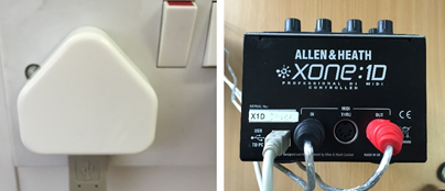

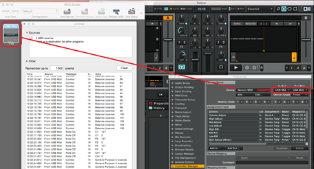

Below are a couple of images to illustrate the above configuration.
- 1st ['generic interface config'] shows connections to a XONE:1D for power and control:
NOTE: MIDI OUT on the adaptor/cable connects to the MIDI IN port on the XONE:1D, and MIDI IN cable to XONE:1D MIDI OUT).
- 2nd ['X1D+GEN.MIDI-USB_TSP_OSX10.10'] illustrates MIDI device settings in the application's hardware preferences - Traktor in this case, noting the 'device' connected is the name associated with the cable/adaptor; USB Midi
NOTE: The host software will not recognize connection is for an A&H device in this context, but control still works fine.
