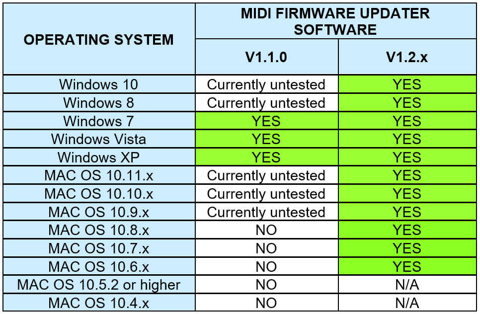

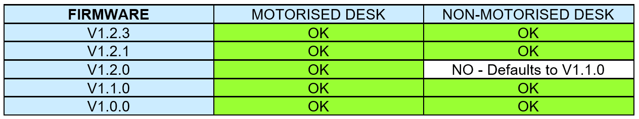

MIDI Firmware
MIDI Firmware updater software

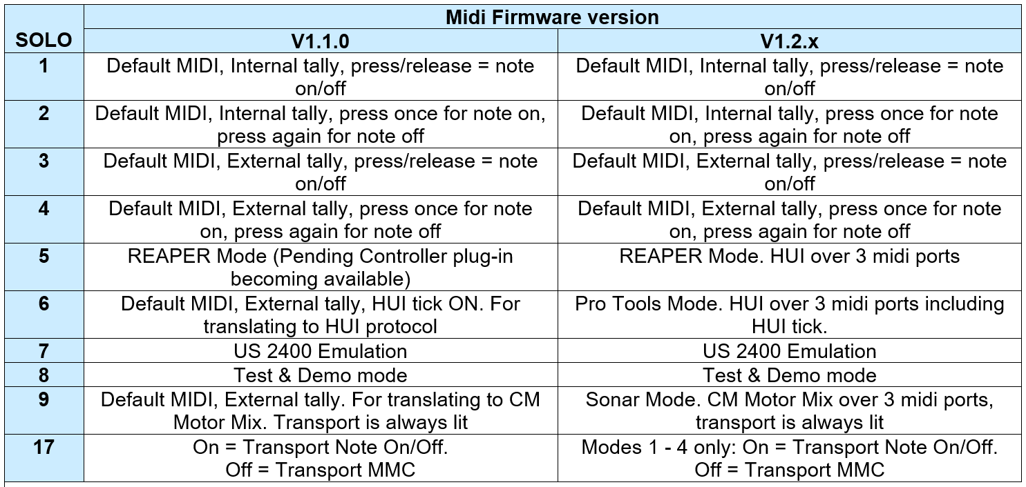

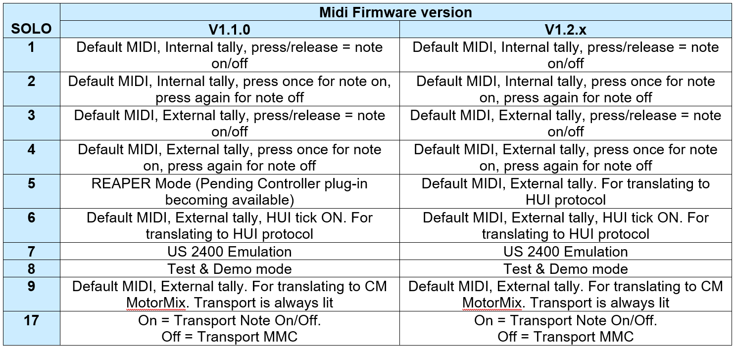

MIDI Operation modes
Power the console ON whilst holding down PLAY.
Release PLAY and press one of the following Solo/SEL buttons.
FireWire MIDI
Standard MIDI port
Press STOP and the configuration mode is set.
