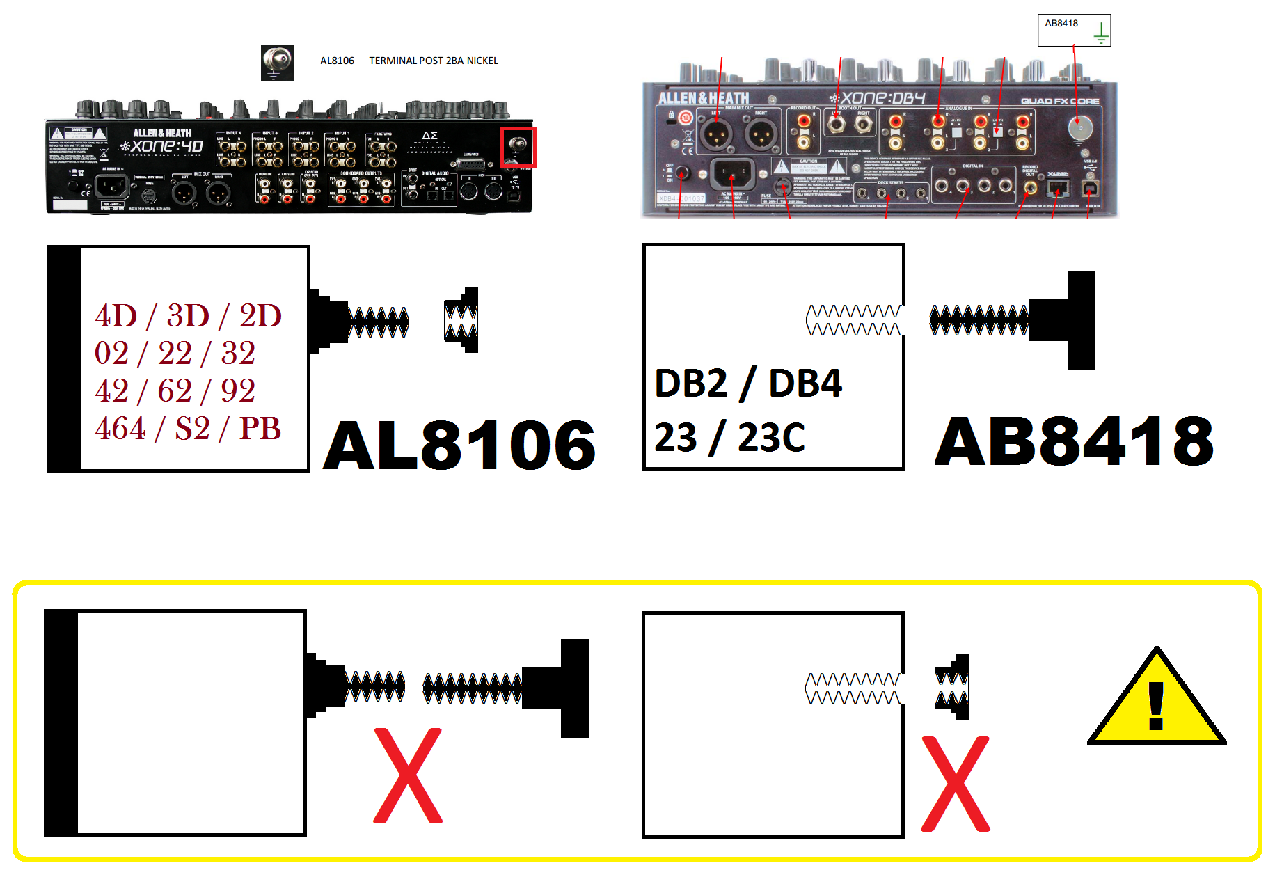

If you have lost the nut for grounding turntables, replacements are available.
Please ensure you order the correct one as some may are not compatible with all models
AL8106 TERMINAL POST 2BA NICKEL EARTH
AB8418 SCREW M4X10 KNURLED DIN464 BZP
