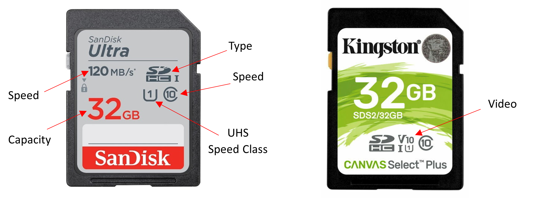

The hardware of Qu consoles support SD cards SDHC, Class 10, UHS-I / U1, for best results, we recommend SD cards with the following markings:
Type: SDHC (SD High Capacity) has a maximum storage capacity of 32GB. While it may seem like a higher capacity is more convenient, a SDXC card with higher capacity may also have a different writing speed.
SDHC cards are also usually formatted to FAT32 by default.
Capacity: Due to the recommendation of SDHC over SDHX, the maximum capacity will be 32GB.
Speed: Writing and reading speed of the card, based on its Speed-Class rate.
Speed Class: Industry standard C10 (Class 10) has a minimum write speed of 10MB/s
UHS Speed Class: UHS-I (Ultra High Speed) theoretical maximum transfer speeds up to 104MB/s
U1 has a minimum sustained write performance speed of 10MB/s
Both U1 and U3 memory cards can utilise the UHS-I bus interface but are not compatible with the UHS-II bus interface.
Video Speed Class: This is in fact not relevant for our application, but it’s worth clarifying the meaning of this marking to avoid confusion.
