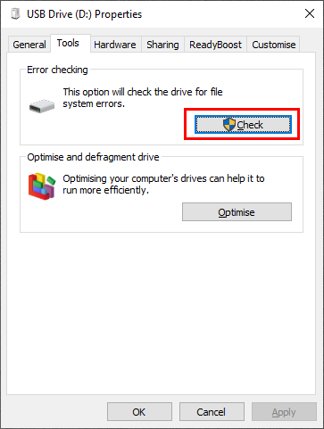

First, connect the SD/USB device to your computer and find the device in Windows Explorer then
Right click on the device > Select 'Properties > Tools > Error-checking’ > Click 'Check'
After running error-check, the files should appear to be the correct size, but will still be corrupt and not load as .wav files as they are missing headers.
