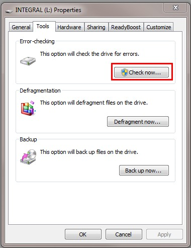

From the Windows Explorer (Highlight USB Media) > Right click > Select 'Properties' > Tools > Error-checking > Check now
In the dialogue box that follows select the following:
Automatically fix file system errors: YES, Scan for and attempt recovery of bad sectors: NO.
After running error-check, the files should appear to be the correct size, but still appear corrupt and will not load as .wav files (as they are still missing headers).
