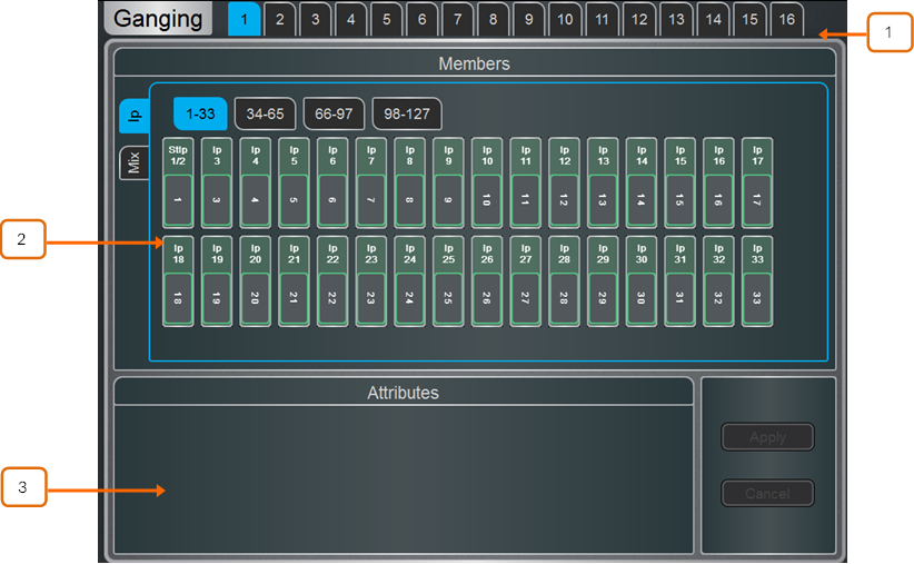

Use this screen to create and edit up to 16 Gang groups. A Gang links all or a selection of processing and routing parameters for two or more channels or mixes of the same type. The channels or mixes in a Gang are known as ‘Members’. The parameters are known as ‘Attributes’.
Ganging provides absolute, not relative control.
🛈 Gang settings follow Scene automation. You can ‘safe’ Gang settings from being overwritten using the Scenes / Global Scene Safes page.
- Touch one of the 16 Gang tabs at the top of the screen to create or edit a Gang group. A Gang with channels already assigned highlights yellow.
- Members – Select either the Input (Ip) or Mix tab. Touch the channels you wish to gang or ungang. A channel or Mix can only belong to one Gang.
- Attributes – Touch the parameters you wish to link. Adding the Routing attribute links the sends and assignments from the ganged channels. Touch Apply to confirm the changes.
🛈 Preamp Gain cannot be ganged. You can set Gain controls to a nominal level, then gang the Trim controls and use to make input level adjustments while mixing. Alternatively, configure a Stereo Input in MixRack / Config / IP Stereo Config to permanently link two Input channels and their preamps within the current Show.
