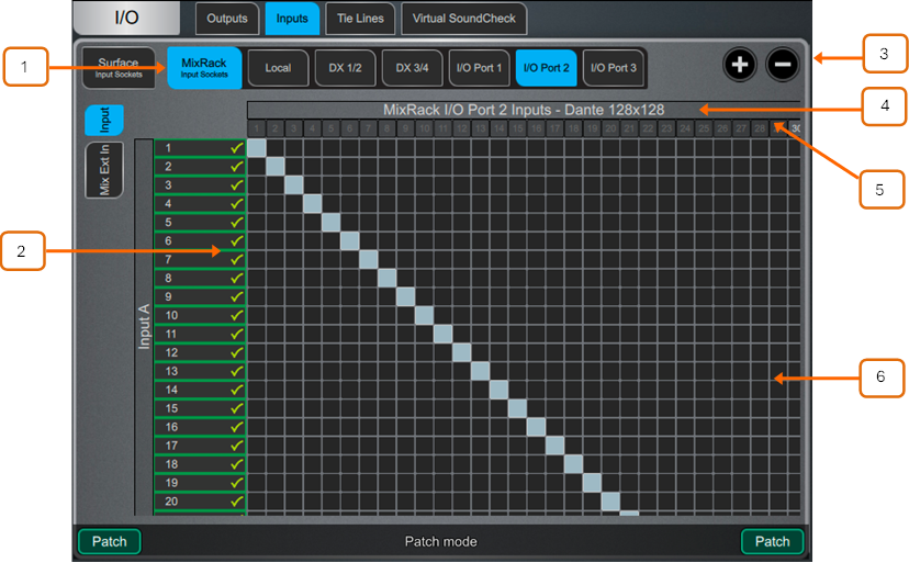

Inputs
Patch sources (displayed on top) to Input channels or to the Ext In of Mix channels (displayed on the left).
- Navigation tabs – Touch on an item to present its associated sources or channels to the matrix view.
- Destinations – Input and Mix channel names and colours are displayed. A green tick appears when any source is assigned to the channel. Touch a channel name or number to edit its name and colour.
- Zoom – Use the two buttons provided or a two-fingers pinch in the screen area to zoom in and out. Low levels of zoom provide a good overview of the I/O patch but disable cross-point operation to prevent accidental changes.
- I/O Card Names – When viewing an IO card tab, the IO card type is listed here. The I/O card name can be swapped out for a custom name, from the Setup menu.
Sources – The source number is greyed out if already patched, highlighted in red if +48V is detected at the socket, or striped when the input is not available in the current system configuration.
Touch on a socket number to open a window with a list of current assignments and available controls for the socket, for example gain, +48V and Pad for a preamp, or SRC options for a digital input.
🛈 When patching from a DT168 or DT164-W expander, preamp controls will appear when a valid patch is made from a DT socket, via a Dante card, to the input channel. Ensure the correct patch is made in both Dante Controller and the dLive’s I/O page.
🛈 Sample Rate Conversion can be bypassed for any stereo digital Input on a dLive Surface or DX32.
- Matrix view – With low levels of zoom, touch on an area of the matrix to zoom in. With higher levels of zoom, touch on a cross-point to patch a source (Patch button disabled). A confirmation popup will appear if the Confirm when reassigning option is enabled. Touch on an active cross-point to unassign.

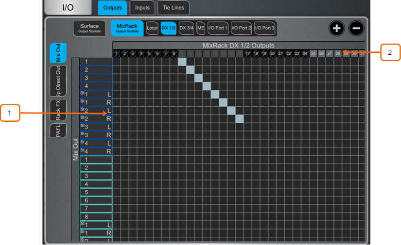

Outputs
Patch Mixes, Direct Outs, RackExtra FX, RackUltra FX or PAFL (displayed on the left) to outputs (displayed on top).
- Sources – Channel names and colours are displayed. Touch a channel name or number to edit its name and colour.
- Destinations – The output number is greyed out if already in use, or striped when the output is not available in the current system configuration.

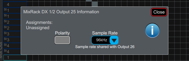

Touch on a socket number to open a window with a list of current assignments and available controls for the socket.
For example, touch on a DX32 digital output to access its Polarity and Sample Rate settings.

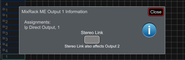

Touch on a ME output to access the Stereo Link option. When Stereo Linked, outputs to the Allen & Heath Personal Monitoring System will be recognised as a stereo pair and assigned to a single key on the ME-1 mixer.

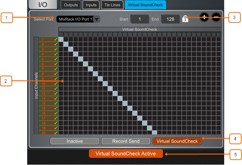

Virtual SoundCheck
Use this page to configure and enable Virtual SoundCheck. The Record Send and Virtual SoundCheck modes are independent of Scene memories. This means you can patch analogue I/O, inserts and FX whilst in Virtual SoundCheck, with the peace of mind that these changes will stay in place when you exit Virtual SoundCheck. It also means that you can recall and store Scenes whilst in Virtual SoundCheck without the need to use Safes or Recall Filters.
- I/O Port – Select the I/O Port to use with Virtual SoundCheck.
- Matrix View – Patch the channels to the I/O Port. It is typical to leave this patch to 1:1 so that Inputs are straight from/to the same numbered I/O Port channel.
- Range – You can limit the range of I/O Port channels dedicated to Virtual SoundCheck. This can be useful if the same I/O Port is used for other applications at the same time, for example for plugin processing or audio distribution. The range selection is locked when in Record Send or Virtual SoundCheck mode.
Inactive disables Virtual SoundCheck. The normal I/O patch is in use.
Record Send sends the pre-trim audio from the Input Channels to the I/O Port for multitrack recording purposes. This will temporarily override the normal output patch to the selected I/O Port, if different.
🛈 The source point is always pre-trim (it doesn’t follow the Input Direct Out source setting). For multitrack recording applications other than Virtual SoundCheck, where the recording of the processed channel is required, go to I/O / Outputs and patch Input Direct Outs instead.
Virtual SoundCheck sends audio from the I/O Port to the Input Channels in place of the live inputs, temporarily overriding the normal input patch.
Virtual SoundCheck Active – A message is displayed on screen to remind the user that Virtual SoundCheck is active. Touch the orange box in any other screen to go back to this screen.
A Virtual SoundCheck button will also appear in the Processing / Preamp screen. This allows you to disable Virtual SoundCheck on individual channels, for example to run a live mic alongside the recorded tracks.
