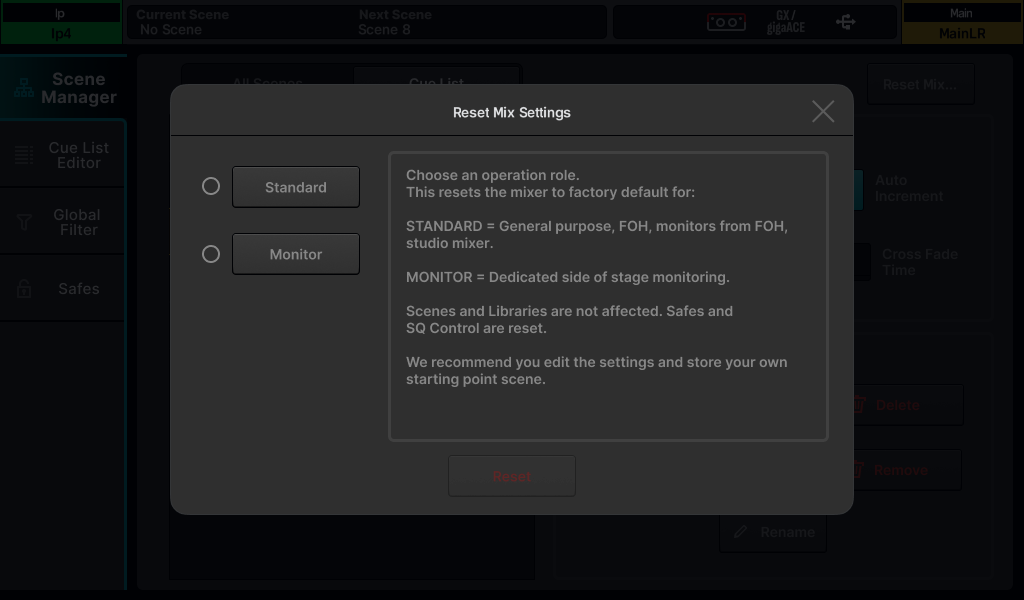

Reset Mix Settings
The SQ+ has multiple ‘Reset Mix Settings’. These are used to ‘zero the desk’ for different uses.
This will clear the current state of the SQ+, but does not affect stored Scene or Library data, so save the current state as a Scene before carrying out this kind of reset if you might wish to recall it later.
Press the ‘SCENES’ screen key, then touch the ‘Reset Mix...’ button in the top left to show the Reset Mix Settings pop-up.
Select an operating role and information on default settings will be displayed. Touch the ‘Reset’ button to reset the mix with these settings.
Global filters are ignored and safes are all switched off when mix settings are reset.
