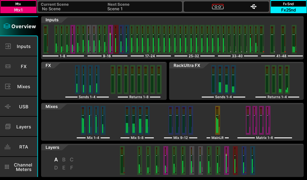

Overview
The Overview displays metering for all channels at once, for at-a-glance checking of levels.
- Touch any section to jump to the more detailed view with larger meters.
ⓘ The Layers section follows Layer selection using the 'LAYERS' keys on the surface.

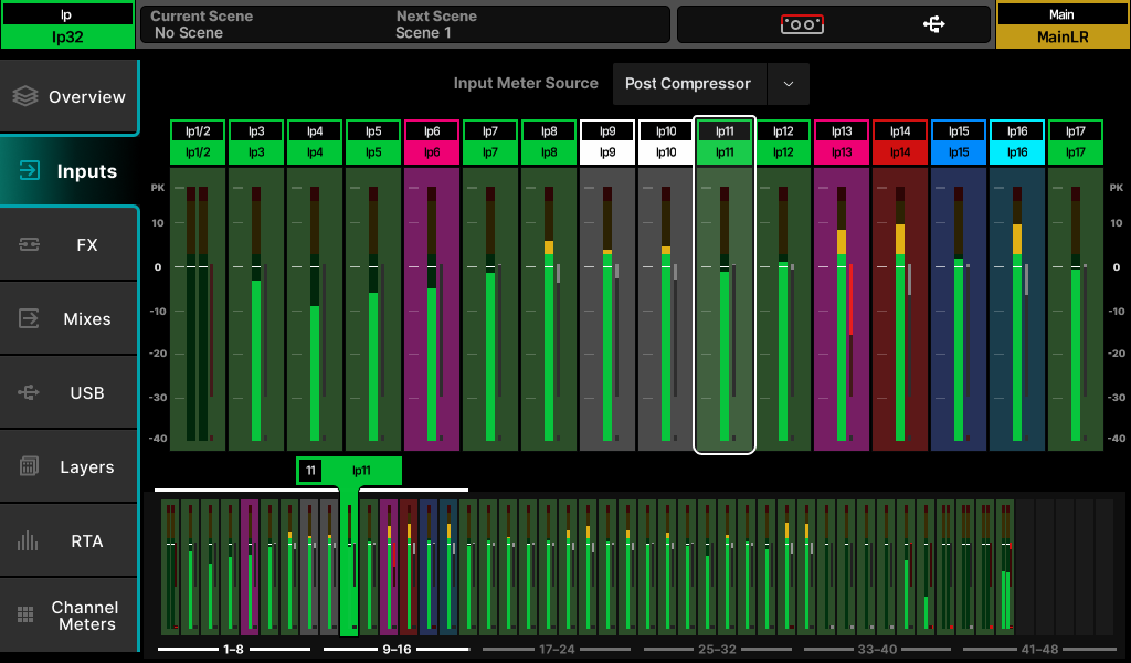

Input Meters –
- Touch and drag left and right to view all channels in the Input Meters screen.
- Touch and drag across the navigation view at the bottom of the screen to quickly jump to any input channel.
- Touch the 'Input Meter Source' setting to choose the metering point for all input channels.
Post Preamp = meter is sourced directly after the preamp.
Post PEQ = meter is sourced directly after the PEQ.
Post Compressor = meter is sourced directly after the compressor.
Post Delay/AMM = meter is sourced after all processing.
ⓘ Note that meter source settings also affect the Chromatic Channel Metering.

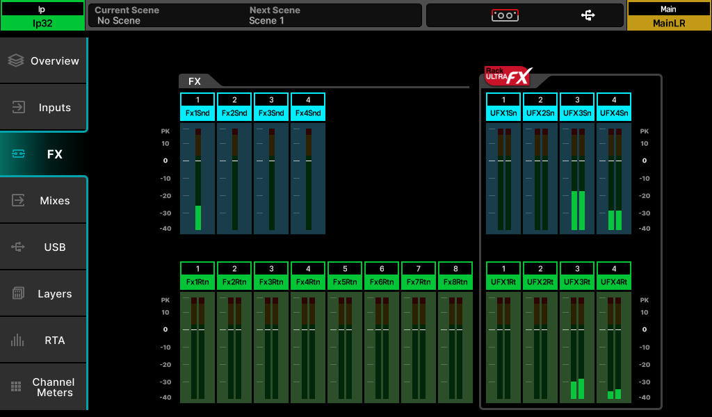

FX Meters –
Includes all dedicated FX Send and Return channels.

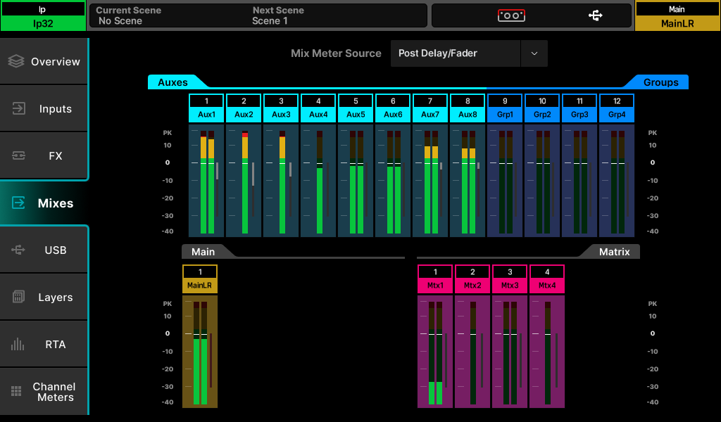

Mix Meters –
- Touch the 'Mix Meter Source' setting to choose the metering point for mix channels.
Post Bus + Ext In = meter is sourced after all channels have been summed, including the mix external input.
Post GEQ = meter is sourced directly after the GEQ.
Post Delay/Fader = meter is sourced after all processing and fader.

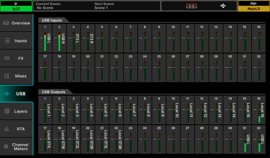

USB Meters –
- ‘USB Inputs’ show levels on the USB stream coming into the SQ+, and labels these with the highest numbered channel or socket they have been patched to.
- ‘USB Inputs’ show either the meters coming from USB-B (when SQ-Drive is not in use for playback) or those from SQ-Drive (when SQ-Drive is being used for playback).
- ‘USB Outputs’ shows the level and source of signals being sent to USB and SQ-Drive.
ⓘ USB Meters always display the maximum 32 channels of inputs and outputs but only the first 16 apply for SQ-Drive when USB sample rate is set to 96kHz.

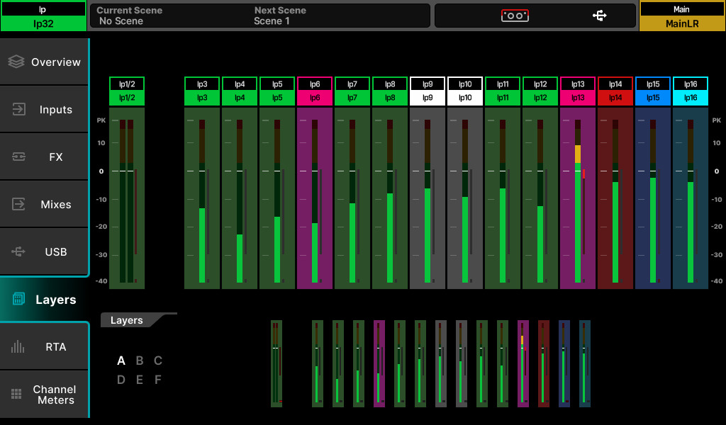

Layers -
Includes all metering for the currently selected channel strip layer.

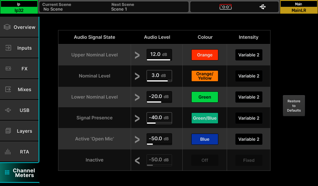

The Chromatic Channel Metering displays the information of a high-resolution meter in the space of a single LED. It can depict a much greater range of levels than a traditional meter and behaviour is customisable in the ‘Channel Meters’ tab.
ⓘ The Chromatic Channel Meter source matches the meter source point selected for Input and Mix Meters.
- Touch an ‘Audio Level’ value and adjust using the touchscreen rotary.
ⓘ ‘Audio Level’ values are bound by the level setting of states above and below.
- Touch a colour for an ‘Audio Signal State’ and use the touchscreen rotary to adjust the colour/s for this level range.
Colours = White, Red, Orange, Orange/Yellow, Yellow, Green, Green/Blue, Blue, Blue/Red, Off.
- Touch the ‘Intensity’ value to choose the behaviour of the meters.
Fixed = meter switches instantly between states.
Variable 1 = Meter changes close to the endpoints of its range.
Variable 2 = Meter changes across the whole range.
- Touch the ‘Restore to Defaults’ button to restore settings:
| Upper Nominal | > | +12.0dB | Orange | Variable 2 |
| Nominal | > | +3.0dB | Orange/Yellow | Variable 2 |
| Lower Nominal | > | -20.0dB | Green | Variable 2 |
| Signal Presence | > | -40.0dB | Green/Blue | Variable 2 |
| Active ‘Open Mic’ | > | -50.0dB | Blue | Variable 2 |
| Inactive | < | N/A | N/A | N/A |

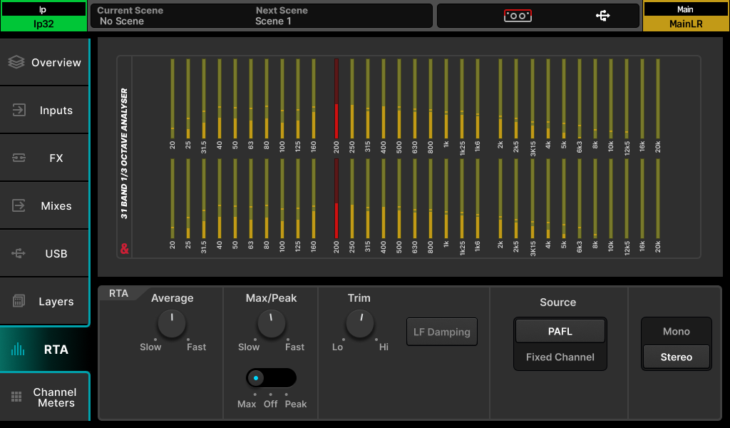

RTA – Meters Screen –
By default, the Meters screen ‘RTA Source’ is set to ‘PAFL’ to match what is being sent to the headphone output and 12 segment LED meter. The source can also be switched to a specific fixed channel if desired.
- The most prominent frequency is shown in red.
- Touch switches or values to select from options or make adjusts using the touchscreen rotary.
Source = PAFL or Fixed Channel.
Fixed Channel = Any input or mix channel.
Mono/Stereo = Stereo 31 band 1/3rd Octave or Mono (L+R) 61 band 1/6th Octave.
Trim = Raise or lower the metering level.
Average Slow to Fast = Adjusts the effective number of samples used by the average (bar) meters.
Max/Peak Slow to Fast = Adjusts the effective number of samples used by the max/peak indicators.
Max-Off-Peak = Max displays the higher of either average or peak, Peak always displays peak (which could be lower than the average meters if Max/Peak is moving faster than Average).
LF Damping = When enabled, response is gradually dampened towards the lowest frequency band, to better represent LF output energy.

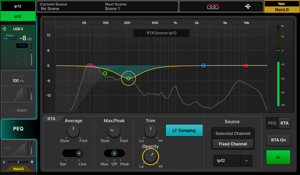

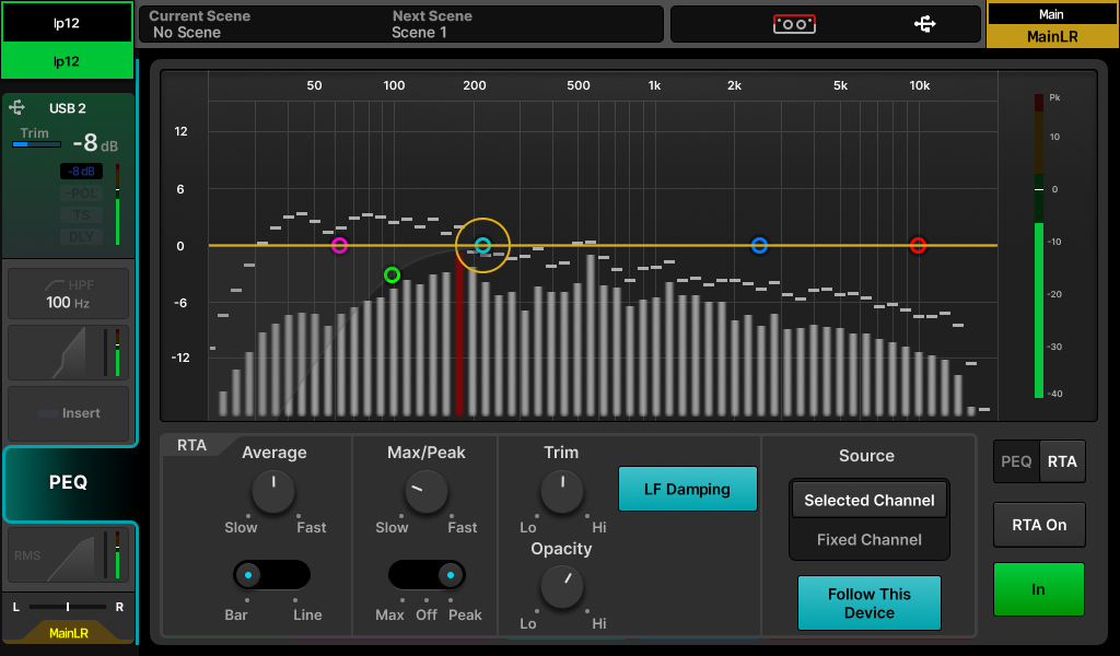

RTA – PEQ Screen –
The 61 band PEQ RTA uses automatic gain control (pre-trim) to display useful relative levels of frequencies on the PEQ graph. By default, it is sourced from the selected channel and is shown on all input and mix channels.
The average meters for the PEQ RTA can either be displayed as bars, with each meter’s centre aligned with the frequency it represents, or as a line.
- If the RTA Source is using the ‘Fixed Channel’ option and is different to the currently selected channel, the current RTA Source channel is displayed at the top.
- If the RTA for a different channel is displayed because it has been selected by another device (e.g. SQ+MixPad), the RTA source is shown at the top.
- When displaying bars, the most prominent frequency is shown in red.
- Stereo sources display metering for L+R.
Source = Selected Channel or Fixed Channel.
Follow this device = When enabled, selecting a channel on this device will also select the Channel RTA source
Fixed Channel selection = Any input or mix channel.
Trim = Raise or lower the metering level on screen.
Opacity = Adjusts the opacity of the RTA metering
Average Slow to Fast = Adjusts the effective number of samples used by the average (bar or line) meters.
Bar-Line = Display multiple bars or a single line.
- Touch the ‘PEQ’ button to return to the PEQ settings.

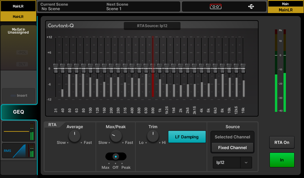

RTA – GEQ Screen –
The 28 band GEQ RTA uses automatic gain control (pre-trim) to display useful relative levels of frequencies for each band of the Graphic EQ. By default, it is sourced from the selected mix channel.
- If the RTA for a different channel is being displayed through use of the ‘Fixed Channel’ option, the RTA source is shown at the top right.
- If the RTA for a different channel is displayed because it has been selected by SQ+MixPad, the RTA source is shown at the top and the RTA meters will not be visible.
