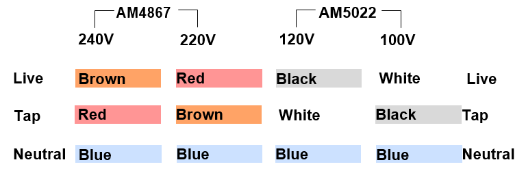

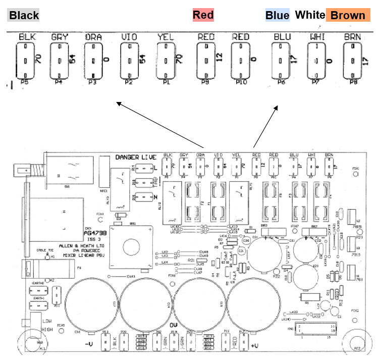

PA CP. Transformer wiring Print to PDF 26 March 2026 12:59 Updated Related articles PA12-CP. Early units with only one LR Stereo fader PA CP. Amplifier Gain PA Series. What are the specifications for the SPDIF output? PA Series. FX stopped working PA12. PA12-CP. Rackmount Kits
