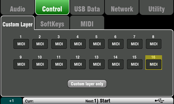

Go to Setup / Control / Custom Layer and set the required fader strips to MIDI by selecting a Custom Layer slot, then change the assignment using the screen rotary.

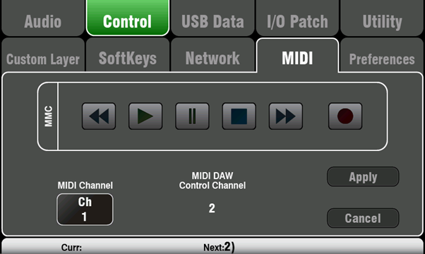

Set the MIDI Channel in the mixer's Setup / Control / MIDI screen. Qu defaults to MIDI Channel 1 (MIDI DAW Control Channel 2).
- If required, set the SoftKeys to MMC transport controls or DAW Bank Up/Down in Setup / Control / SoftKeys.

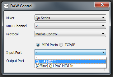

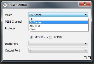

Launch A&H MIDI Control and double click in the MIDI Control icon in the tray menu (or right click, then click on Show Preferences) to access the configuration panel.
Select Qu as the Mixer.
- Select the MIDI channel as set in the mixer. This is normally set to Ch. 2 to match the default MIDI DAW Control Channel used by the Qu MIDI strips.
- Select MIDI Ports for USB connection to the mixer, or TCP/IP for Cat5 network connection.
MIDI Ports - Select the MIDI Input and Output ports to be used, for example Qu-16 MIDI Out and Qu-16 MIDI In.
TCP/IP - Select the mixer from the drop-down box or select Custom and type in the IP address of the mixer, then tick the Connect checkbox.

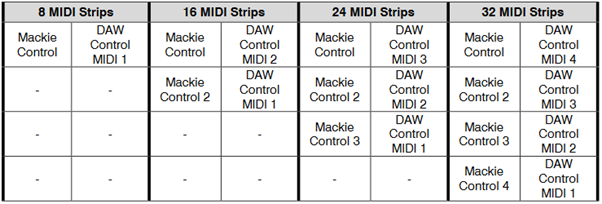

Create a Mackie Control device for each block of 8 MIDI strips present on the mixer and assign to ‘not connected’ before assigning the corresponding MIDI ports.
Note: The top-most device in the left-handlist represents the right-most block of MIDI channel strips:
i) Click on the Add Device button (+), select Mackie Control and set the input and output ports to ‘not connected’.
ii) Click Apply.
iii) Repeat this for up to 4 devices in total (32 MIDI strips)
iv) Assign the input and output MIDI ports of each device to the DAW Control MIDI ports as follows:
