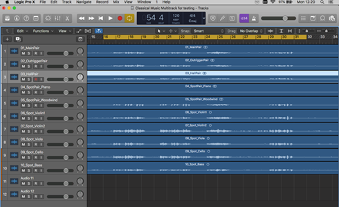

If you have imported multitrack stems into a DAW such as Logic X, you may find that you need to change the output routing of the DAW. By default, most DAWS have all the inputs routed to the master LR track. You will need to change the output routing of the DAW to be the in the DAW Preferences.

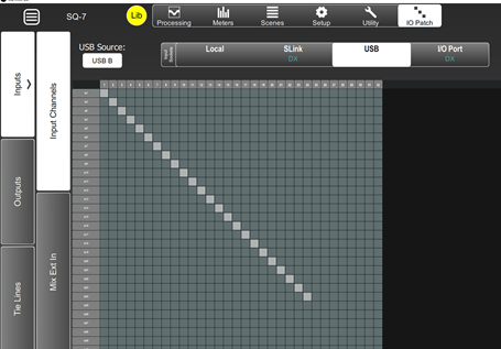

On the I/O Page of the SQ, you need to assign the input channels to the USB B. You will then receive audio signal from the DAW to the input channels of the SQ.
