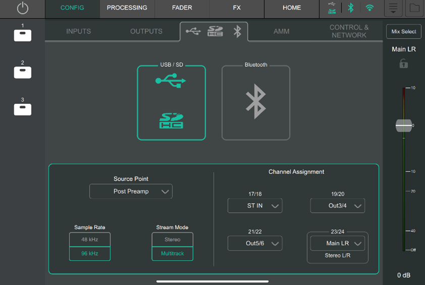

1.- On your CQ, go to CONFIG / Digital Audio (Symbols) / USB/SD.

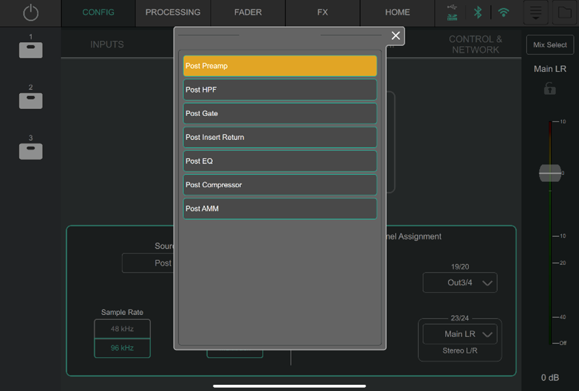

2.- Select the Source Point from which the signal will be sent to record.
3.- Select the Sample Rate. 48kHz allows for longer recording time and more channels to be recorded at a lower quality. 96kHz allows a maximum of 16 channels to be recorded for a shorter time but at the highest quality.

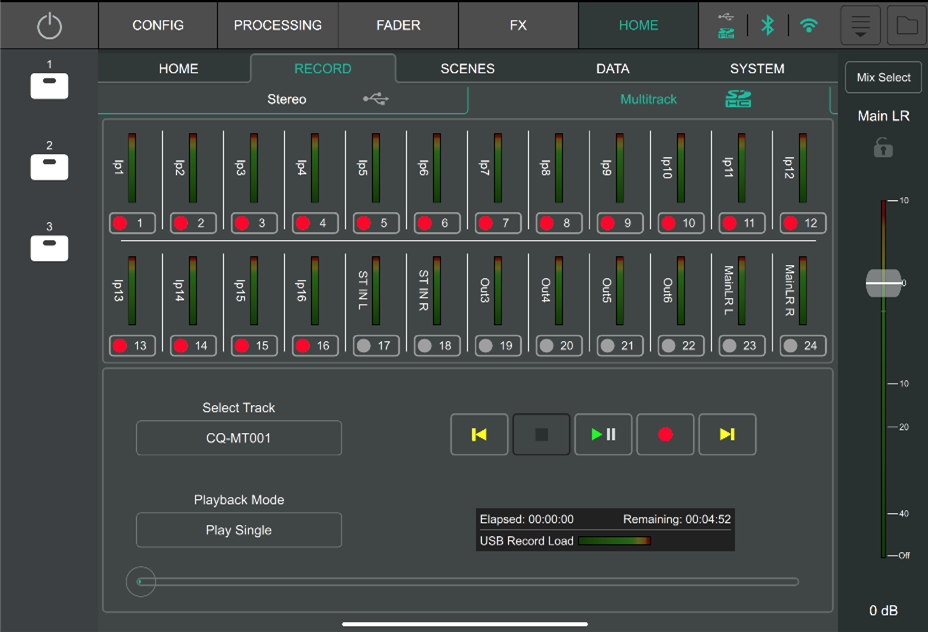

4.- Go to HOME / RECORD / Multitrack
5.- Arm each channel to be recorded using the Arm button below each channel meter. Armed channels are indicated with a red record symbol.
6.- Ensure channels that are not to be recorded show a grey record symbol, showing they are unarmed.
7.- Use the Recording button in the transport bar to start recording to the SD card. A new folder will be created with empty files then recording will begin automatically.
8.- Press the Stop button to finish the recording. When each recording is stopped, allow time for the recording to be finalised and the files stored correctly.

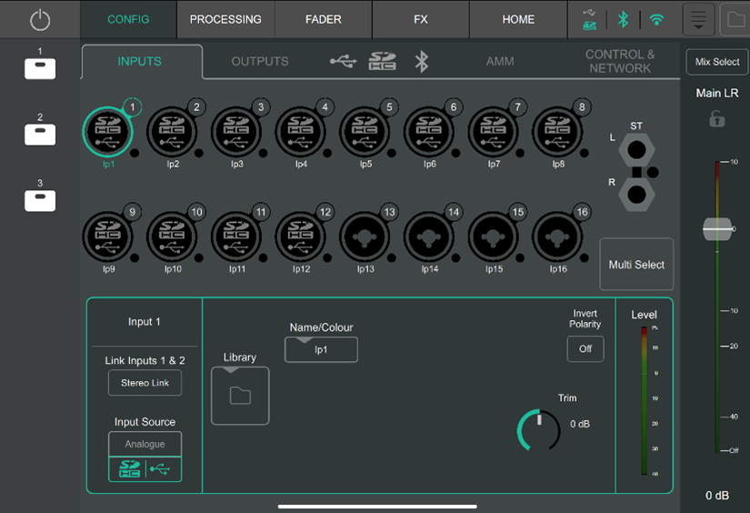

4.- Go to CONFIG / INPUTS and select the required channels according to the number of tracks on your Multitrack file; Use Multi Select to select multiple inputs at the same time, then switch these channels Input Source to USB/SD.
5.- Go to HOME / RECORD / Multitrack.
6.- To select a stored multitrack file from the SD Card, touch the Select Track drop-down menu at the left bottom corner of the screen.
7.- If a recording cannot be seen, it may be due to the recordings being a different Sample Rate than the current CQ setting. Try changing the Sample Rate (Step 2).
8.- Use Playback Mode to select whether some, all or none of the recordings will be repeated.
9.- Use the Transport bar to control playback.
