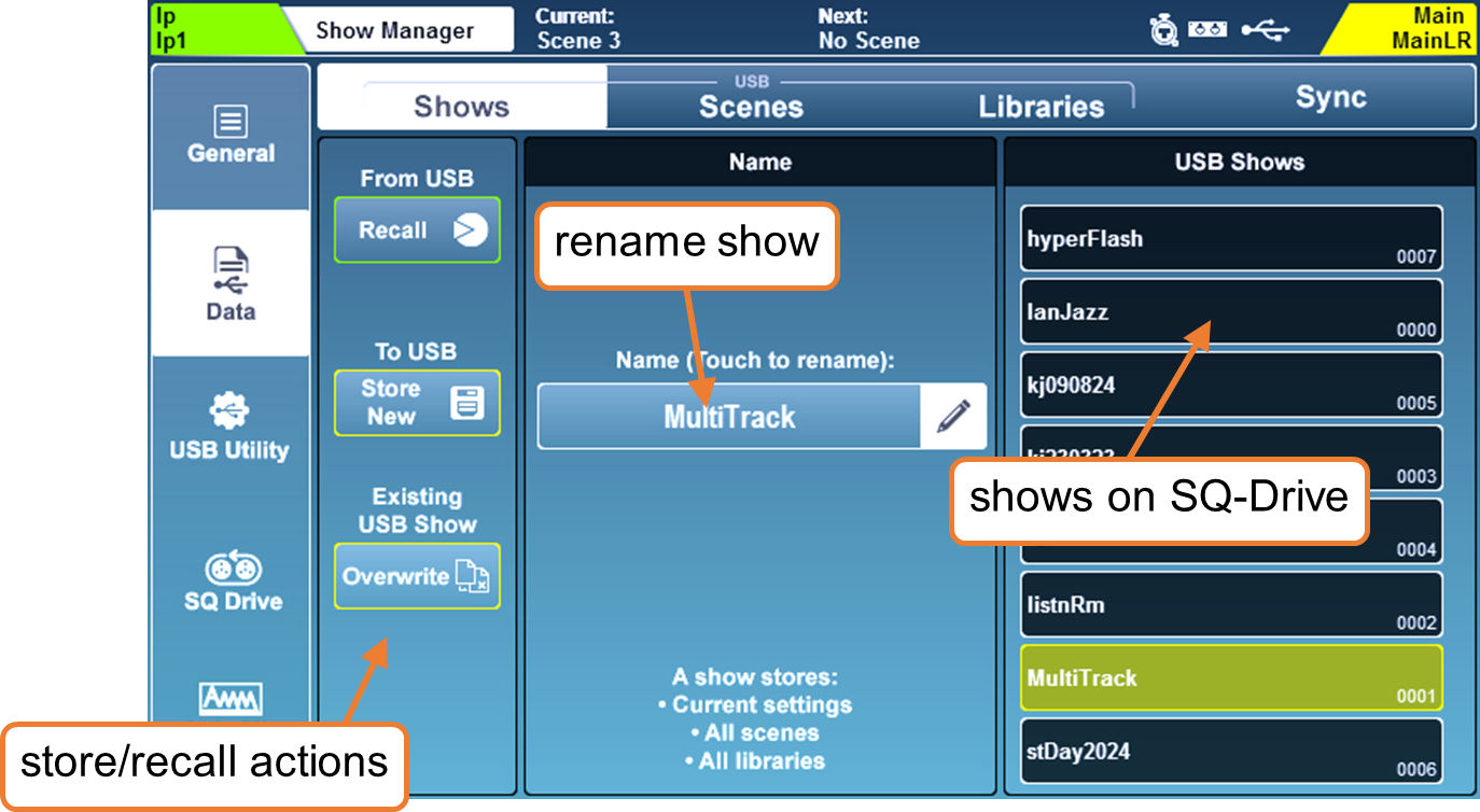

All mix settings in SQ can be stored and recalled in either ‘Scenes’ or ‘Show’ files.
Scenes are intended for recall during use, whilst a Show file contains everything for an event or particular set up. Show files can also be used to make a backup of a configuration or transfer it to another unit.
• A ‘Scene’ is a snapshot of all mix settings.
• There are 300 scene slots available per ‘Show’.
• In addition to all of the scenes, a ‘Show’ includes all SQ settings (such as Chromatic Channel Metering and Integrated Surface Illumination settings).
• The SQ can have one ‘Show’ on it at any one time. Multiple ‘Show’ files can be stored or recalled using SQ-Drive and SQ-MixPad.
• Up to 100 'Shows' can be stored on each external storage device.

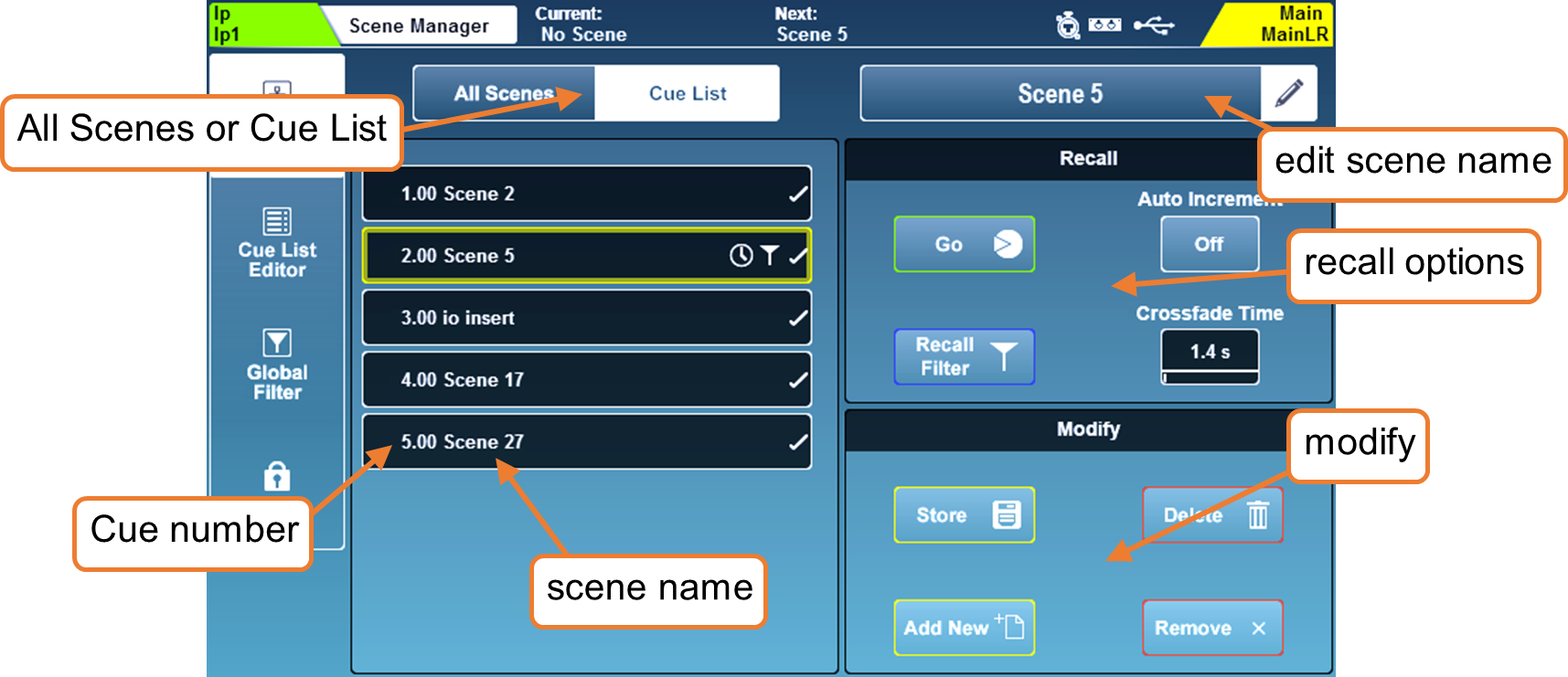

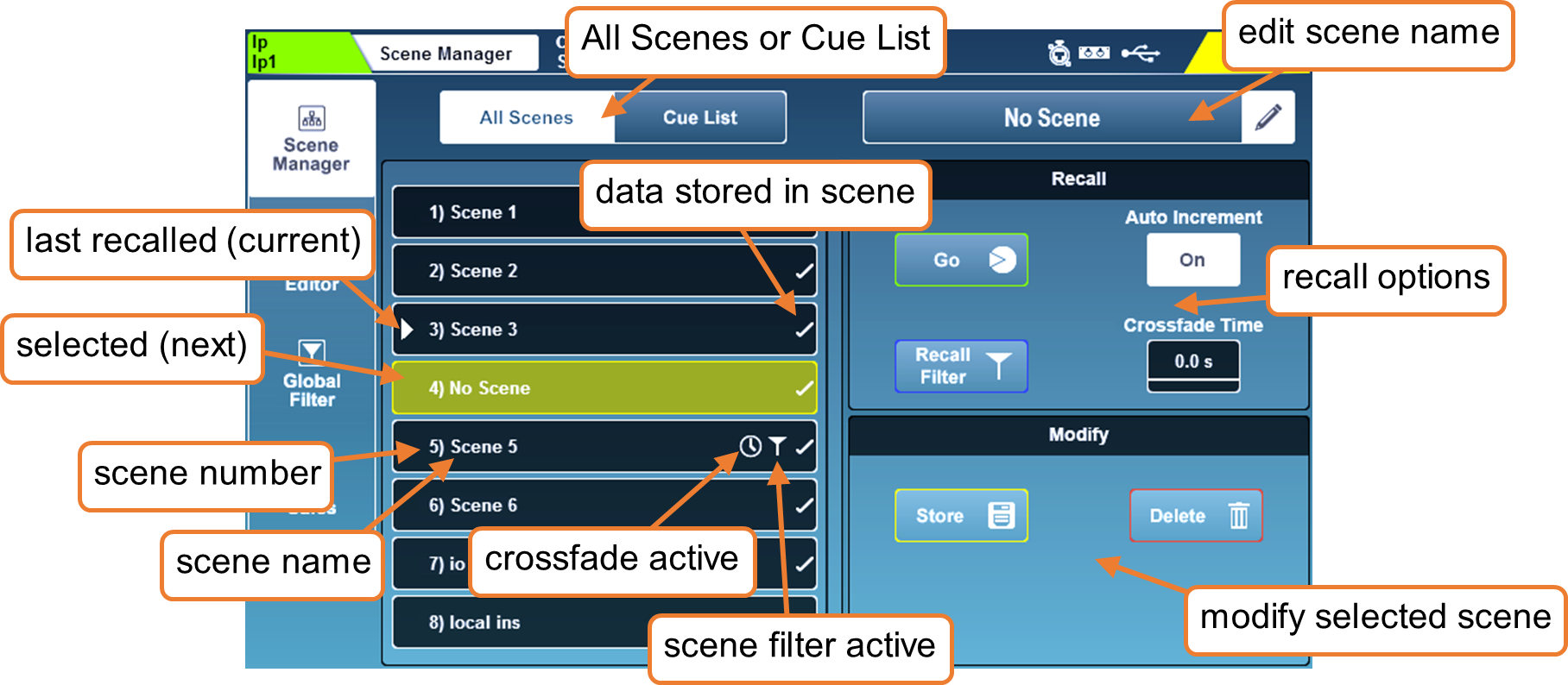

Scene Manager
The Scene Manager allows the current state of the mixer to be stored as a Scene, Scenes can also be recalled, overwritten, deleted or have per-scene recall filters and crossfades applied.
Scene Manager Mode -
Touch the ‘All Scenes’ / ‘Cue List’ button above the scene list to choose the Scene Manager ‘mode’. ‘All Scenes’ works directly with all 300 scene slots. The ‘Cue List’ is like a playlist of cues, each with an associated scene, to allow for easy inserting, reordering, repetition and renumbering.
ⓘ The Scene Manager mode is global and affects external recall of Scenes via the SQ-MixPad app.
All Scenes Mode -
All 300 scene slots are listed and numbered, touch and drag up and down or touch to select then use the touchscreen rotary to scroll through all slots.
To store the current state of the SQ to a new slot:
• Touch any empty slot.
• Touch the ‘Store’ button to save with the name ‘Scene [slot number]’.
OR
• Touch in the empty scene name field to be prompted to name the scene at the same time as storing it.
To recall a scene and replace the current state with the stored state:
• Touch a scene to highlight it then touch the ‘Go’ button.
To rename a scene:
• Touch the scene, then touch in the edit scene name field at the top of the screen.
To overwrite a scene with the current state of the SQ:
• Touch the scene to overwrite, then touch the ‘Store’ button.
To delete a scene:
• Touch the scene you wish to delete then touch the ‘Delete’ button.
ⓘ You can choose whether or not to confirm scene operations (and avoid accidental overwriting) by using the ‘Confirm Scene Operations’ button found in Surface Preferences.
To quickly copy, paste or delete scenes in All Scenes:
• Hold the ‘Copy’ key and touch the scene you wish to copy.
• Hold the ‘Paste’ key and touch the scene slot in which you’d like to paste it.
• Hold the ‘Reset’ key and touch a scene to delete it.
Cue List Mode –
Each Cue in the list has an associated scene from one of the (up to 300) scenes in the current show. Cue numbers are displayed instead of the scene slot number.
To store the current state of the SQ into the next empty scene slot and add/insert a new cue for that scene after the currently selected cue:
• Touch the ‘Add New’ button to save with the name ‘Scene [slot number]’.
To recall a cue/scene and replace the current state with the stored state:
• Touch a cue/scene to highlight it then touch the ‘Go’ button.
To rename a scene (note that this renames the scene, not the cue):
• Touch the cue/scene, then touch in the edit scene name field at the top of the screen.
To remove a cue from the Cue List without deleting the associated scene:
• Touch the ‘Remove’ button.
• Touch the cue/scene to overwrite, then touch the ‘Store’ button.
To delete a scene completely (from the Cue List and the SQ):
Scene Crossfades –
A Crossfade Time can be applied to each scene individually and is stored within that scene.
This smoothly transitions send levels and panning/balance between their previous state and their state in the scene (with the crossfade applied) which is being recalled.
• Select the scene to apply the crossfade to, then select the ‘Crossfade Time’ value and use the touchscreen rotary to adjust.
Crossfade Time = 0 to 20 seconds
Note that the crossfade applies to audio processing only. Actual fader positions and on-screen values will immediately display where they will be at the end of the crossfade time at the point of recall.
Auto Increment –
With Auto Increment turned on, recalling a scene using the ‘Go’ button on the Scene Manager screen will automatically select the next used scene slot in the All Scenes list or the next scene in the Cue List. Meaning the ‘Go’ button can be pressed repeatedly to move through the scenes sequentially.
ⓘ The Auto Increment setting on this screen does not affect the ‘Scene Recall Go’ SoftKey option, which has a separate Auto Increment option available.

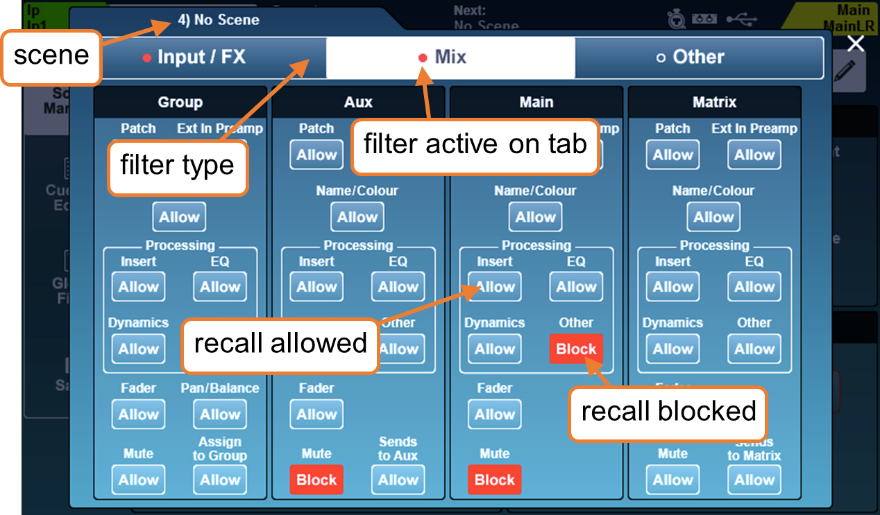

Scene Filters –
When storing a scene, all mix settings are saved. However, it is possible to filter what is recalled using a combination of scene recall filters and global filters.
ⓘ See Global Filters for information on what each filter allows or blocks.
To choose which filters are allowed or blocked per scene:
• Touch a scene or cue to highlight it then touch the ‘Recall Filter’ button.
• In the pop-up, there are three tabs ‘Input/FX’, ‘Mix’ and ‘Other’ containing all available filters.
• Touch any filter button to switch between ‘Allow’ and ‘Block’.
• Blocked parameters will not be affected when recalling the scene.
ⓘ The Copy/Paste/Reset keys can also be used with the ‘Recall Filter’ button when in All Scenes mode.
ⓘ Global Recall Filters take precedence over Scene Recall Filters.

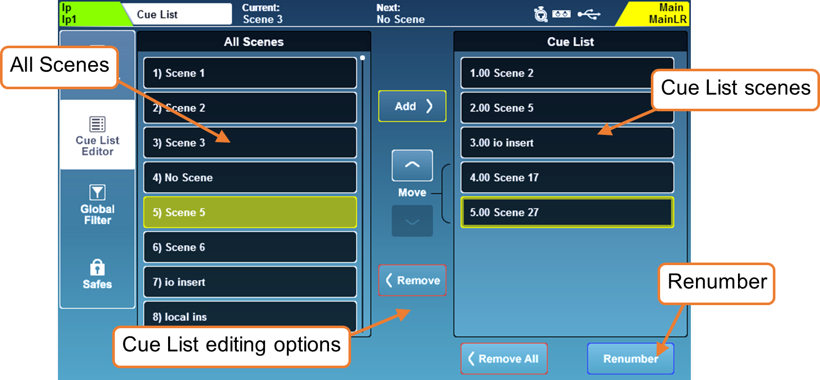

Cue List Editor
The Cue List Editor allows cues to be added, inserted and removed from the Cue List in the same way as is possible in Cue List mode in the Scene Manager screen. Additionally, it’s possible to clear the Cue List completely as well as reorder and renumber it.
To add/insert a new cue for a scene into the Cue List:
• Touch a stored scene in the All Scenes list on the left.
• Touch a cue in the Cue List on the right.
• Touch ‘Add’ to add a cue for the selected scene after the selected cue.
ⓘ When inserting a new cue, it will be automatically numbered based on its position in the Cue List.
To remove scenes from the Cue List (this will not delete scenes from the SQ, only remove the cue for it from the Cue List):
• Touch the cue to be removed.
• Touch the ‘Remove’ button to remove it.
OR
• Touch the ‘Remove All’ button to completely clear the Cue List.

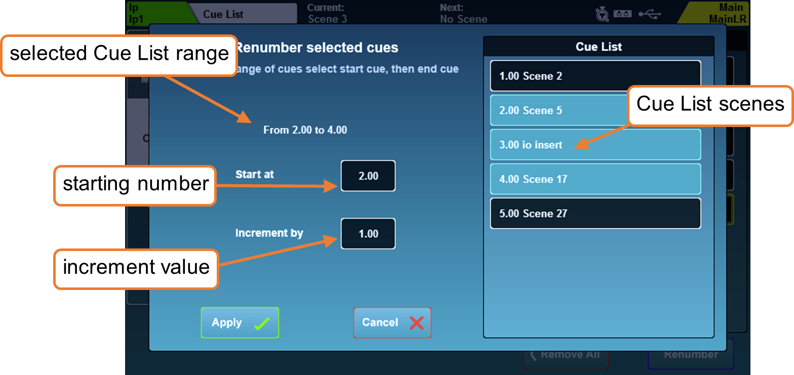

Cue List numbering and renumbering –
The Cue List is numbered to two decimal places, allowing scenes inserted between two existing scenes in the Cue List to be automatically assigned a number between the two without changing the existing numbering.
This is for systems and setups using external triggering via MIDI Show Control to prevent those triggers from needing to be changed if extra scenes are inserted.
It is possible to renumber the Cue List scenes at any time however, by touching the ‘Renumber’ button to show the Renumbering popup.
To renumber a range of cues in the Cue List:
• Touch the first cue in the range you wish to renumber.
• Touch the last cue in the range you wish to renumber.
• Touch the ‘Start at’ value and use the touchscreen rotary to select the number for the first cue in the range.
• Touch the ‘Increment by’ value and use the touchscreen rotary to select how much the number for each consecutive cue will be incremented by.
• Touch the ‘Apply’ button.
ⓘ Setting ‘impossible’ values that clash with or overlap existing cues will cause the ‘Apply’ button to be greyed out.
ⓘ Setting a ‘Start at’ value higher than the final cue is possible, but will move the range of cues to the end of the Cue List to ensure all cues remain in numerical order.
ⓘ Setting values which allow the entire range to fit between two existing cues is possible and will move the range to that position to ensure all cues remain in numerical order.

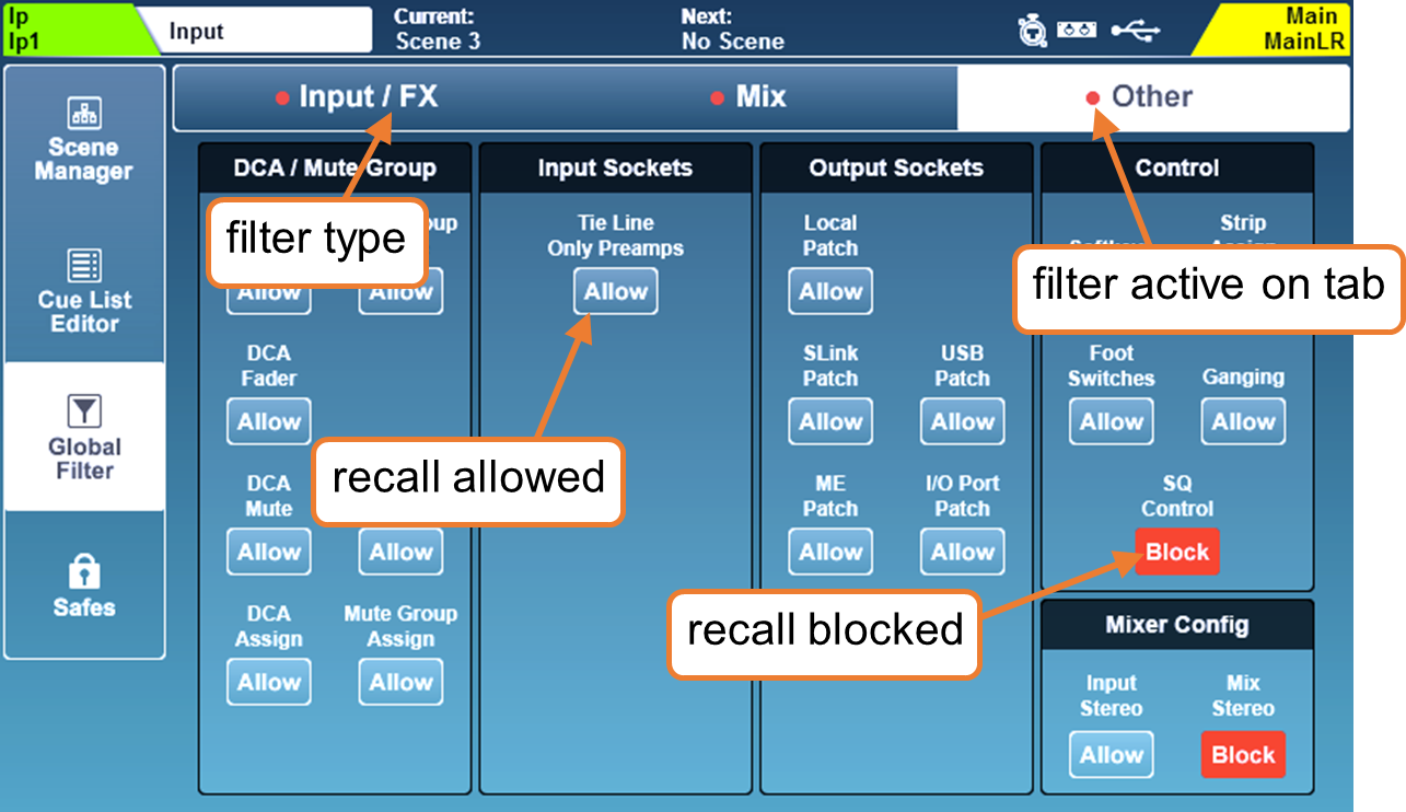

Global Filters
Global scene filters are always active, and affect which settings are changed when recalling a scene. They also override any active scene filters.
• Blocked parameters will not be affected when recalling scenes.
ⓘ It is common to block ‘SoftKeys’, ’SoftRotaries’, ‘Footswitches’ and ‘SQ-Control’, so they continue to function in the same way whenever scenes are recalled.
ⓘ Changes to Talkback and PAFL Ext In patching and preamp parameters are always blocked as these are show level parameters.
ⓘ All output socket filters also affect socket settings e.g. AES sample rate setting.

Other Filters –
| DCA/Mute Group | |
| Filter | Includes |
| DCA Name/Colour | All DCA names and colours |
| Mute Group Name | All Mute Groups names |
| DCA Fader | All DCA fader values |
| DCA Mute | All DCA mutes |
| Mute Group Mute | All Mute Group mutes |
| DCA Assign | All DCA member assignments |
| Mute Group Assign | All Mute Group assignments |
| Input Sockets | |
| Filter | Includes |
| Tie Line Only Preamps | Preamp parameters for connected sockets not assigned to a channel |
| Output Sockets | |
| Filter | Includes |
| Local Patch | All patching to local output sockets (XLR, TRS and AES) |
| SLink Patch | All patching to the SLink port |
| USB Patch | All patching to USB (SQ-Drive and USB-B) |
| ME Patch | All patching to the ME system (SLink or I/O Port) |
| I/O Port Patch | All patching to the I/O Port |
| Control | |
| Filter | Includes |
| SoftKeys | All SoftKey assignments |
| Strip Assign | Channel strip layout |
| Soft Rotaries | All Soft Rotary assignments |
| Footswitches | Footswitch assignments |
| Ganging | All ganging assignments and linked parameters |
| SQ-Control | SQ-Control layout |
| Mixer Config | |
| Filter | Includes |
| Input Stereo | Mono/stereo state of odd/even Input channel pairs |
| Mix Stereo | Mono/stereo state of Group, Aux and Matrix channels |

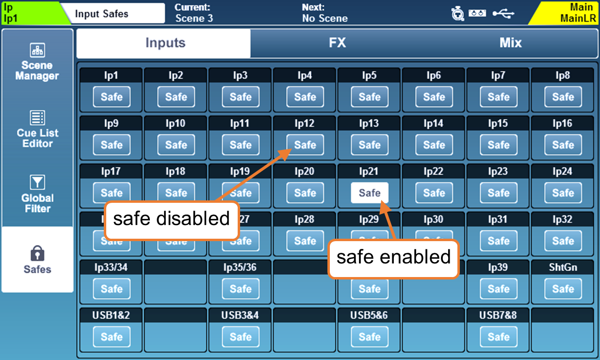

Safes
‘Safes’ block any changes to a channel when recalling a scene.
• Touch ‘Input’, ‘FX’ or ‘Mix’ tabs to view all channel safes.
• Touch a ‘Safe’ button to safe the channel (the button will turn white).

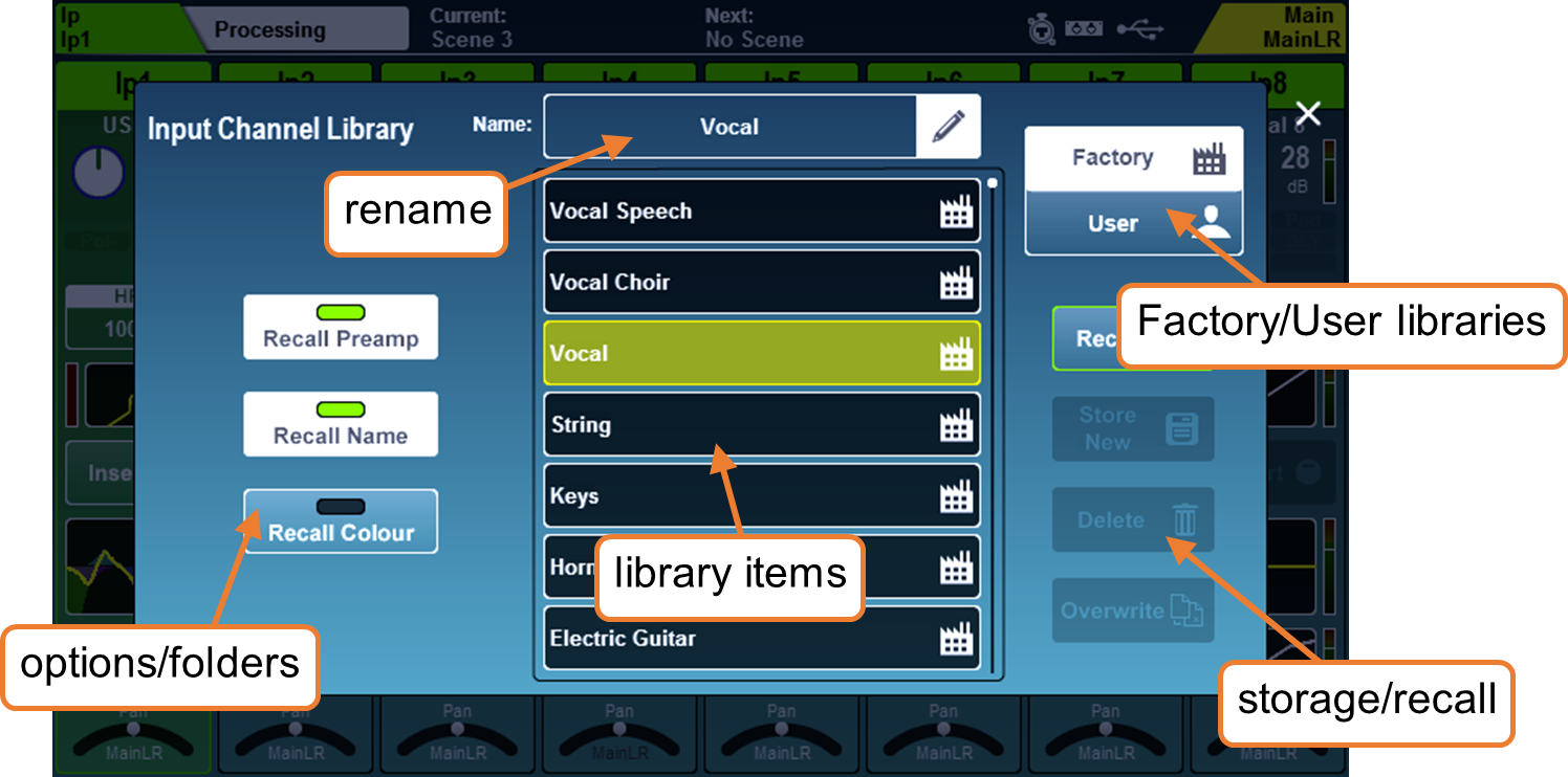

Libraries
Factory Libraries and User Libraries are available for many features and processing in SQ and can be accessed by using the dedicated Library key when in certain screens.
ⓘ The 'Library' key will illuminate whenever a library is available for the screen being viewed.
Factory libraries provide presets and are also used to recall different FX units or DEEP plug-ins. They are fixed in firmware and cannot be edited or overwritten.
To recall from the library:
• Go to the screen you wish to recall parameters for.
• Press the ‘Library’ key.
• Select the Factory or User library item you wish to recall.
• Touch the ’Recall’ button.
To store or overwrite a library item:
• Go to the screen you wish to store parameters for with the settings you wish to store visible.
• Select the User library in the top right of the screen.
• Touch the ’Store New’ button to store a new library item.
OR
• Select a library item and touch the ‘Overwrite’ button.
To delete a library item:
• Select the library item you wish to delete.
• Touch the ’Delete’ button then confirm to delete the item.

USB Shows –
To store a show to a USB device:
• Touch the ‘Store New’ button - you will be prompted to name the show.
To recall a show:
• Touch a show to highlight it (use the touchscreen rotary to change selection or scroll through all shows) then touch the ‘Recall’ button.
To rename a scene:
• Touch a show, then touch in the ‘Name’ field in the centre of the screen.
To overwrite a scene:
• Touch the scene to overwrite, then touch the ‘Overwrite’ button.
ⓘ Storing or recalling shows is not possible when SQ-Drive is being used for recording or playback.
ⓘ Storing or recalling shows will interrupt USB-B audio streaming.

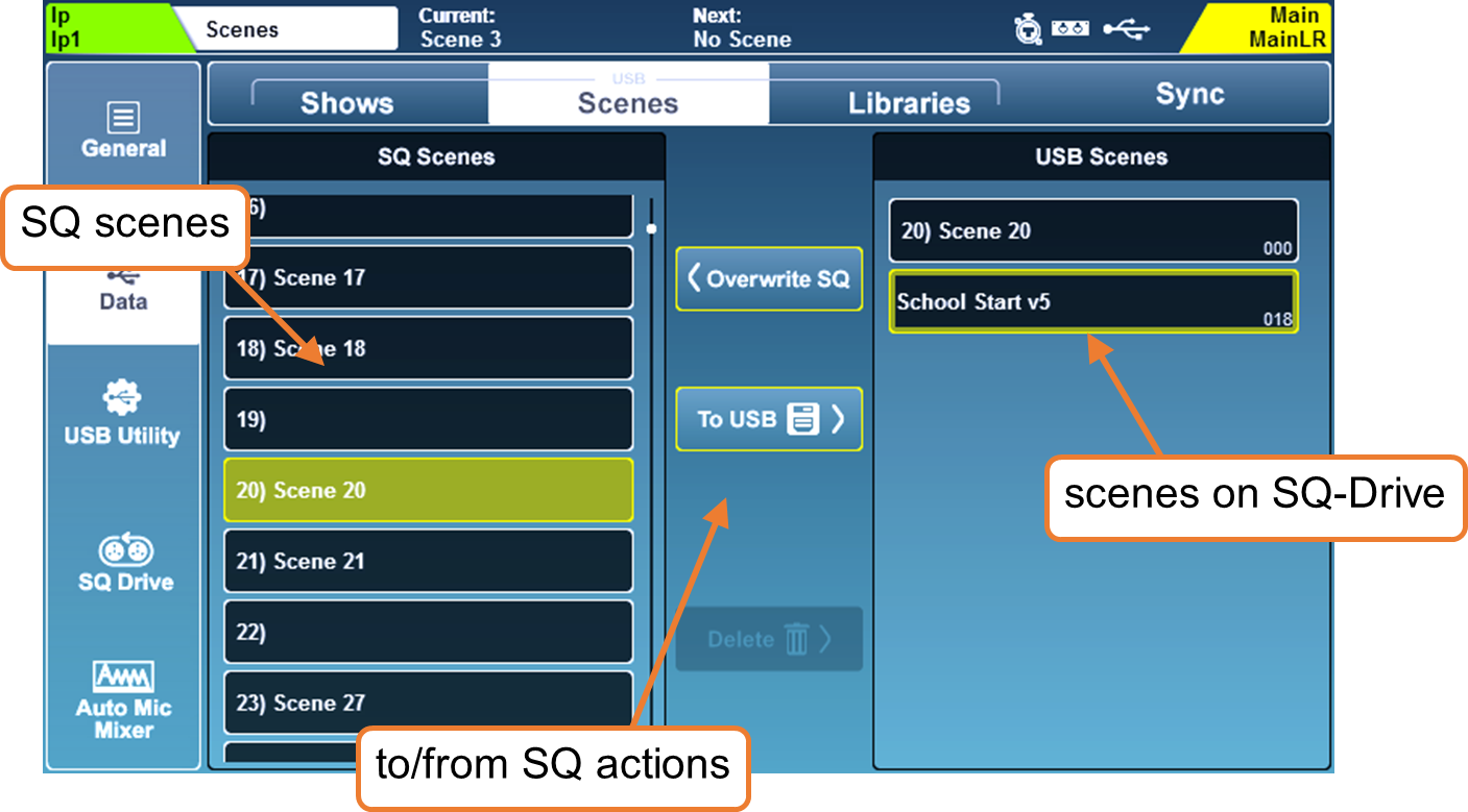

USB Scenes –
To store an individual scene to a USB device:
• Touch to select the scene you wish to store in the ‘SQ Scenes’ list on the left.
• Touch the ‘To USB’ button.
To transfer a scene from USB to the SQ:
• Touch to select the scene to transfer in the ‘USB Scenes’ list on the right.
• Touch to select an empty slot in the ‘SQ Scenes’ list on the left.
• Touch the ‘To SQ’ button to transfer.
• Touch to select the scene to overwrite in the ‘SQ Scenes’ list on the left.
• Touch the ‘Overwrite SQ’ button to transfer and overwrite the SQ scene.
To delete a scene from USB:
• Touch to select the scene to delete in the ‘USB Scenes’ list on the right.
• Touch the ‘Delete’ button and confirm the action in the pop-up.

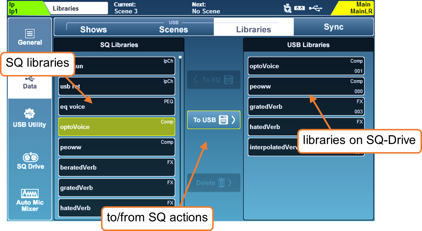

USB Libraries –
To store an individual library item to a USB device:
• Touch to select the library item you wish to store in the ‘SQ Libraries’ list on the left.
ⓘ All user libraries in the current show are displayed.
To transfer a library item from USB to the SQ:
• Touch to select the library to transfer in the ‘USB Libraries’ list on the right.
To overwrite a library item:
• Touch to select the library item to transfer in the ‘USB Libraries’ list on the right.
• Touch to select the library item to overwrite in the ‘SQ Libraries’ list on the left.
• Touch the ‘Overwrite SQ’ button to transfer and overwrite the SQ library item.
To delete a library item from USB:
• Touch to select the library item to delete in the ‘USB Libraries’ list on the right.

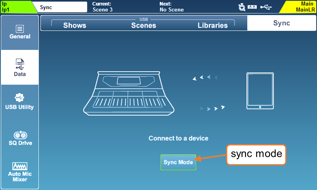

Sync –
To push or pull data using the SQ-MixPad app, the SQ console must be in sync mode. This avoids accidental overwriting of the current data on either the SQ console or SQ-MixPad.
To enter sync mode, go to the ‘Utility’ screen, then touch ‘Data’ followed by ‘Sync’.
Touch the ‘Sync Mode’ button then confirm you understand the implications of sync mode in the pop-up to proceed.
Once in sync mode, pushing and pulling of data is controlled by SQ-MixPad.
ⓘ User permissions for the current user of both the console and SQ-MixPad must allow ‘Sync Push’ and/or ‘Sync Pull’ to transfer a show.
ⓘ Refer to SQ-MixPad help for more information on data transfer to and from MixPad.
ⓘ Starting sync mode will disconnect all devices aside from the one being connected to as all network bandwidth is required without interruption.
