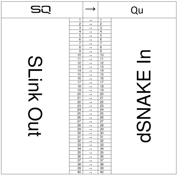

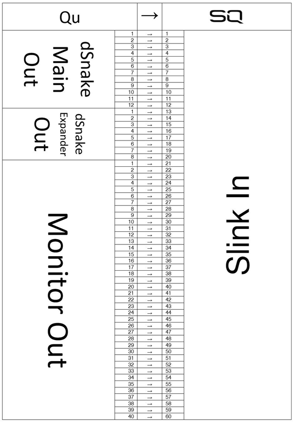

General. How to connect Qu & SQ Print to PDF 26 March 2026 12:59 Updated The SQ (v1.1.0 +) can send and receive audio with the Qu (v1.93 +) over the dSnake protocol. Related articles SQ. Example patching SQ to SQ General. What are the supported dSnake configurations? General. Connecting to the SLink port Qu Classic. How do I route audio to and from my Qu mixer and a DAW? General. Recommended WiFi router and basic setup
