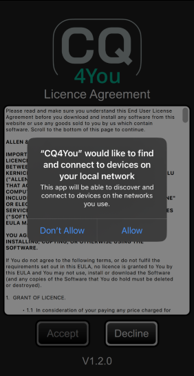

Settings - Privacy and Security - Local Network and turn on the all of your Allen & Heath apps or reinstall the app and pay attention to and accept the information below;
"CQ4You" would you like to find and connect to devices on your local network
This app will be able to discover and connect to devices on the networks you use.
