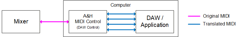

Allen & Heath MIDI Control works by creating virtual MIDI ports in Mac OS or Windows and then facilitating a MIDI connection between these virtual ports and the mixer either with or without translation.
This enables compatible Allen & Heath mixers to control DAW software on Mac OS or Windows by emulating popular HUI or Mackie Control protocols.
It can be used to send and receive MIDI control messages directly to and from a digital mixer’s core for remote control of mixing parameters, scene changes and other functions.
ⓘ Compatible mixers send and respond to MIDI messages as detailed in the MIDI Protocol specification documents for each range, available for download from www.allen-heath.com.
Simplified control of the most common mixer parameters with MIDI CC messages from the computer is also made possible with the ‘CC Translator’ options.
Creation of virtual MIDI ports
Virtual MIDI ports are created every time Allen & Heath MIDI Control is started up and whenever the protocol setting is changed.
Therefore, to ensure that your DAW or any other application recognises these ports correctly, it is best practice to set up your mixer and MIDI Control before starting your DAW or any other application.

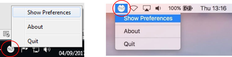

Launch Allen & Heath MIDI Control which will open and run as a background task. Right click on the icon in the system tray (Windows) or right click/control click on the icon in the menu bar (Mac) then click on Show Preferences in the menu to access the preferences panel.

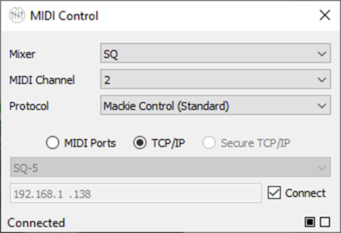

MIDI Control Preferences
The two squares at the bottom right of the window display MIDI I/O activity.
To check you are connected to the mixer, move any MIDI fader on the mixer and the left indicator should flash. Similarly, when messages are being sent from the computer, the right indicator will flash.
Mixer - Select the mixer type/range you are connecting to.
MIDI Channel - This should match either the MIDI channel of the mixer itself, or for control surface use, the DAW Control MIDI channel. For example, by default, the Qu MIDI channel is 1 and the Qu DAW Control MIDI channel is 2.
Protocol - Select a protocol to choose whether translation is carried out.
- HUI/Mackie Control – Translates MIDI messages from the mixer to emulate a control surface.
- Mackie Control (Standard/Alt Display) – This option is available for SQ and Qu-5/6/7, which can display channel naming on the channel strip LCD displays. The Mackie control protocol allows for two rows of text, so these options simply switch which row is displayed.
- MIDI Thru – All messages are passed to and from the mixer without translation. Use this to control the mixer according to its MIDI protocol, or to receive direct MIDI output from MIDI channel strips. This should also be used for simple program/scene changes and to receive MIDI output from SoftKeys or Soft Rotaries.
- CC Translator – Translates simple MIDI Control Change (CC) messages and Note On/Off messages from the computer to NRPN messages for control of a mixer’s audio channel faders and mutes (see page 6).
Connection - Select MIDI Ports for USB connection to the mixer (CQ, Qu, SQ), TCP/IP for a network connection or Secure TCP/IP for a secured network connection.
- MIDI Ports – Select the MIDI Input and Output ports to be used, these could be via a MIDI interface or a direct USB connection to the mixer (CQ, Qu, SQ), for example Qu-16 MIDI Out and Qu-16 MIDI In.
- TCP/IP or Secure TCP/IP – Select the mixer from the drop-down box or select Custom and type in the IP address of the mixer, then tick the Connect checkbox.
ⓘ For a network connection, make sure your computer and the mixer are set to compatible IP addresses within the same subnet.
