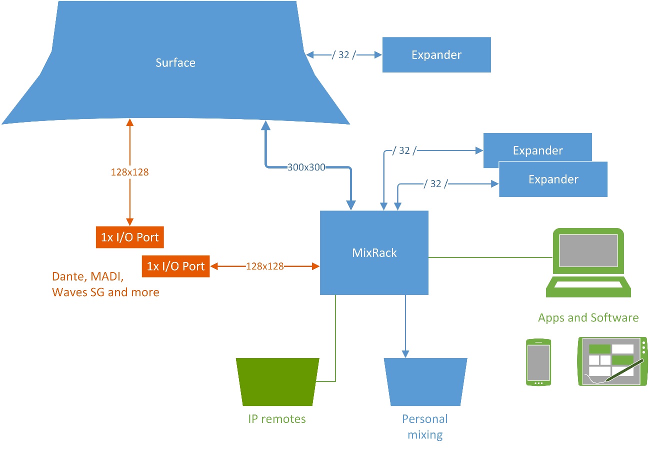

dLive is a distributed digital mixing system providing a uniquely flexible solution for any live sound application. It separates the mix engine from the control surface, putting the audio and processing where it is needed, and offering a host of control and audio networking possibilities. Refer to the Allen & Heath website to find out more about dLive.
The MixRack is the heart of any dLive system. It houses the XCVI processing core complete with audio I/O, control and audio networking ports. It is typically connected to a dLive Surface, but can also be controlled at the same time as or even without a Surface using a laptop or iPad, Allen & Heath IP remotes or third party controllers via TCP/IP. DX Expanders can be added to the system for extra I/O.

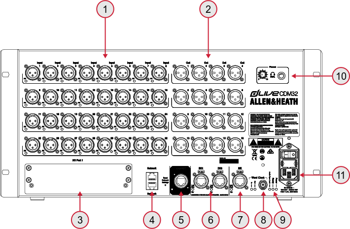

Rear Panel
Mic/Line inputs - Recallable preamps for balanced or unbalanced microphone and line level signals. Gain, Pad and 48V are digitally controlled within the preamp.
The PP indicator lights up when phantom power voltage is detected at the socket, whether internally or externally sourced.
Any socket can be patched to any Input Channel using the I/O or Processing / Preamp screen.
- Line outputs – Line level, balanced XLR outputs. Nominal level +4dBu. Signals can be patched to any output socket using the I/O screen.
I/O Port – Audio interface port providing 128x128 channels. Fit one of the option cards available for system expansion, digital mic splitting, recording or distributed audio networking. Refer to www.allen-heath.com for a list of available option cards.
ⓘ iLive / GLD option cards (M-Dante, M-Waves, M-ES-V2, M-ACE, M-MADI) can be used with dLive when fitted with the M-DL-ADAPT ‘letter-box’ adapter. This provides a 64x64 48kHz interface with built-in Sample Rate Conversion.
Use the I/O screen to patch signals from or to the I/O Port.
Network –2x RJ45 Gigabit Ethernet ports. Connect a laptop or a wireless router to use with dLive Editor or iOS apps. All devices on the network must have compatible IP addresses.
ⓘ A recessed switch lets you reset the network settings to factory default. To reset, turn the MixRack off, insert a pointed object to press and hold the switch whilst turning the MixRack back on. Hold the switch in for at least 20 seconds.
- gigaACE link – MixRack to Surface link over Gigabit Ethernet (IEEE 802.3 Layer 2 compliant). A single Cat5e (or higher) cable carries bidirectional 96kHz audio and control.
DX links – EtherCon ports for connection of up to 4 DX expanders over Fast Ethernet (IEEE 802.3 Layer 2 compliant). A single Cat5e (or higher) cable carries 32x32 channels of 96kHz audio and control. The ports are numbered DX1 and DX3. DX2 and DX4 are dedicated to redundant connections on the dLive DM MixRacks.
Use the I/O screen to patch signals from or to the DX expanders.
ME - Dedicated EtherCon port for the Allen & Heath ME personal mixing system. A single Cat5e (or higher) carries 40 channels of 48kHz audio, channel names and stereo links. Connect a ME-1 mixer for daisy chaining or ME-U hub for power and audio distribution.
Use the I/O screen to patch signals to the ME system.
- Word Clock I/O - BNC connector for syncing from an external audio clock or providing a clock to other devices. Use the MixRack / Audio / Audio Sync screen to select the input or output function and clock source.
Audio Sync Lock indicates that the audio is sync locked to a valid clock source. If this does not light up then check that the correct clock source is selected in the MixRack / Audio / Audio Sync screen.
Power indicates the correct functioning of the PSU.
- The Ready indicator lights up when the output sockets are ready to pass audio after power up.
- Phones - Standard 1/4” jack socket and level control for the built-in headphone amplifier. The output follows the PAFL selection.
Mains – IEC socket, On/Off rocker switch and fuse.
A plastic P-clip cable clamp is provided to secure the mains cable. Slot the cable in or lock it in place using a star Torx© T20 screwdriver to refit the clamp around the cable.

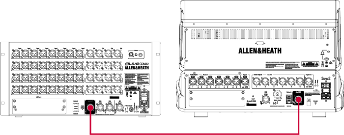

- Fan – Ultra-quiet fan. Make sure the ventilation opening is not obstructed.
