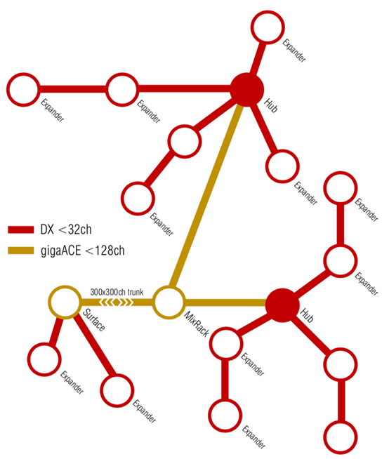

Mixed topologies, scalable systems
The gigaACE and DX protocols are designed to integrate and seamlessly work together in a dLive system, allowing for flexible audio distribution and positioning of I/O devices, with Gigabit Ethernet connections where required, and taking advantage of both daisy-chain and star topologies.
Each connection can be up to 100m, or longer when using fibre optics, thus covering any size of application from small venues to a large campus. Many audio professionals are led to believe point-to-point Layer 2 protocols are not as scalable as AoIP solutions, yet an Allen & Heath dLive system can offer in excess of 800 analogue inputs across up to 48 discrete I/O points.
