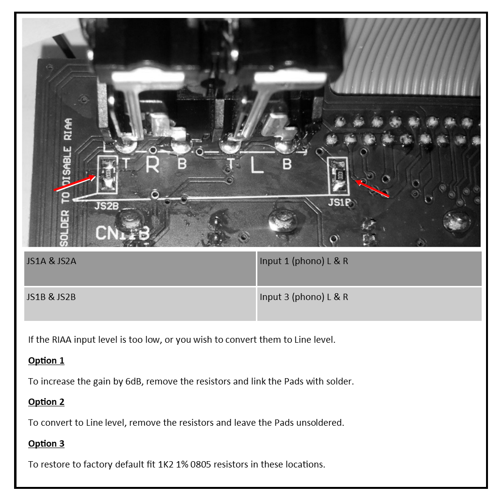

The RIAA stage can be increased by +6dB. This is achieved by removing resistors from the underside of the front panel PCB and linking the pads with solder. The pads are located directly behind the RCA connectors. Alternatively, the inputs can be converted to line level simply by leaving the pads unsoldered.

Step 2 pad configuration
Once the top panel has been removed from the top. Place face down on a clean flat surface.
There are two resistors for each stereo input. Please modify both per input for the desired configuration from the options below.
