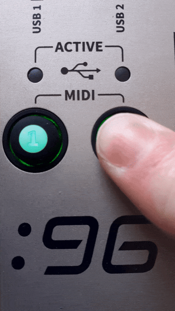

This can be action on either USB 1, or 2, or both simultaneously. Simply press and hold the corresponding MIDI active button for 5(+) seconds. The blue active LED will start to flash, and remain solid once reconnection to a host computer been established.
Above shows this being action on USB 2 of the 96 dual soundcard.
